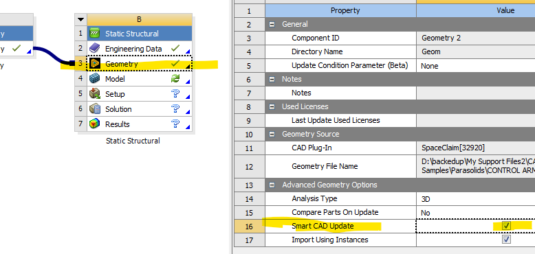

SubscriberIt does have a message "One or more parts were found to be unmodified so smart updated." Then the geometry remains unchanged.
March 21, 2022 at 6:13 pmGary Stofan
Ansys EmployeeSo the message means the geometry did not update.

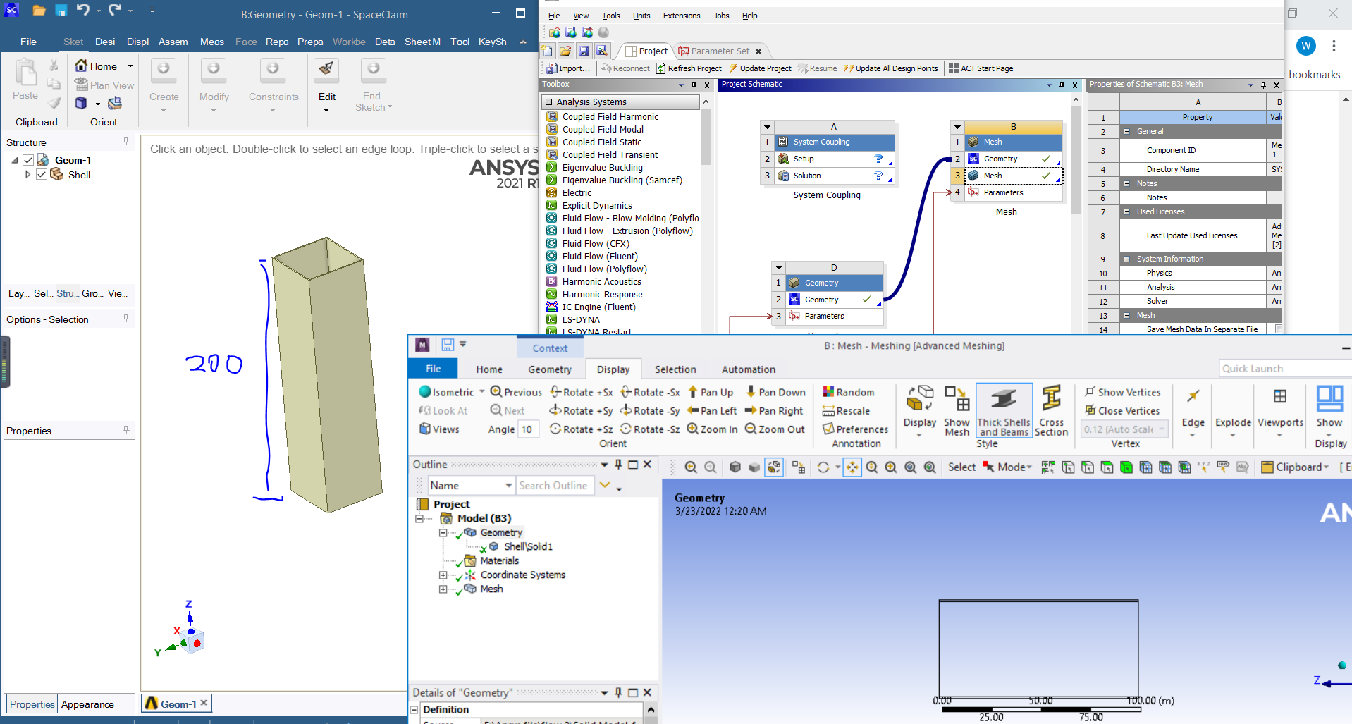

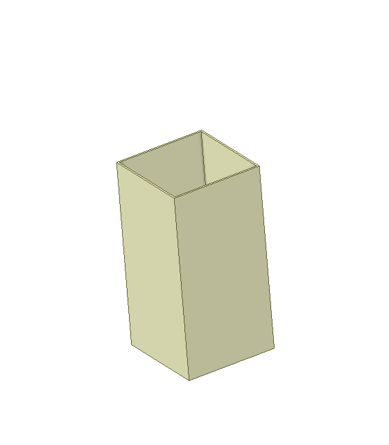

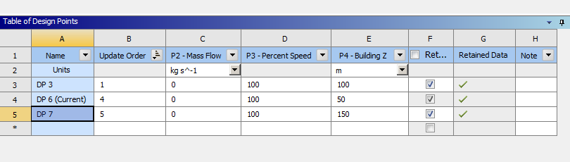

SubscriberSo I tried using a simple shell building geometry. The initial height of the building is 50 meters. The first parameter is increasing the height by 50 meters at DP6, therefore, the total height of the building is 100 meters. At the first parameter (DP6), the geometry is able to update at the MESH cell, creating a 100-meter model. However, when the design point changes, the geometry (DP7) is updated at the Geometry Cell while the MESH cell remains the same from the initial parameter (DP6). I set the DP7 as "Current" and opens the MESH Cell. The same error message : "One or more parts were found to be unmodified so smart updated." is listed as Warning under Message. Could this be a geometry problem?? I am using Autocad to create my geometry and export it as IGES file into Spaceclaim.
