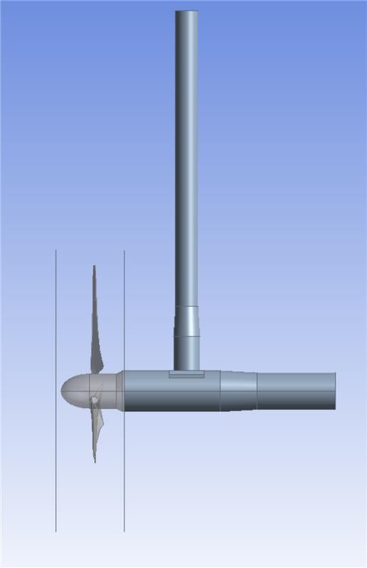

SubscriberHello, I'd really appreciate some help with a persistent Fluent issue. I am performing tidal turbine simulations using Ansys FLUENT 2024R1 (although I also encountered the problem using 2025R2). I am using a sliding mesh technique where a disk is placed on the turbine blades, and then the turbine is boolean subtracted from both the disk and the outer domain (a box) to leave a void (as the turbine is not to be meshed). This is shown below:

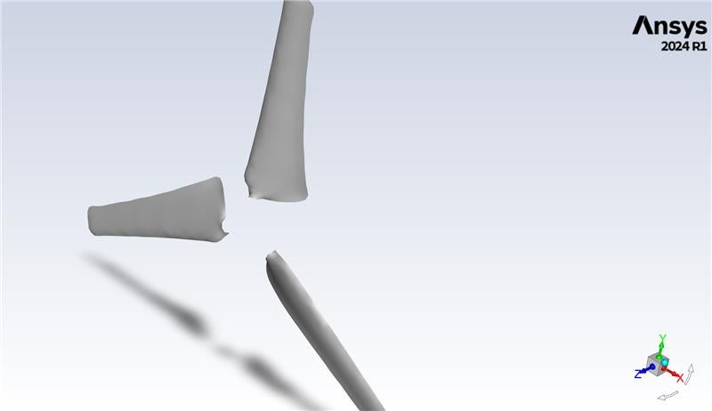

Named selections are applied so that the turbine_walls apply to rotating walls around the void inside the disk, and support_structure_walls apply to the stationary walls around the void in the outer domain. This is shown below:

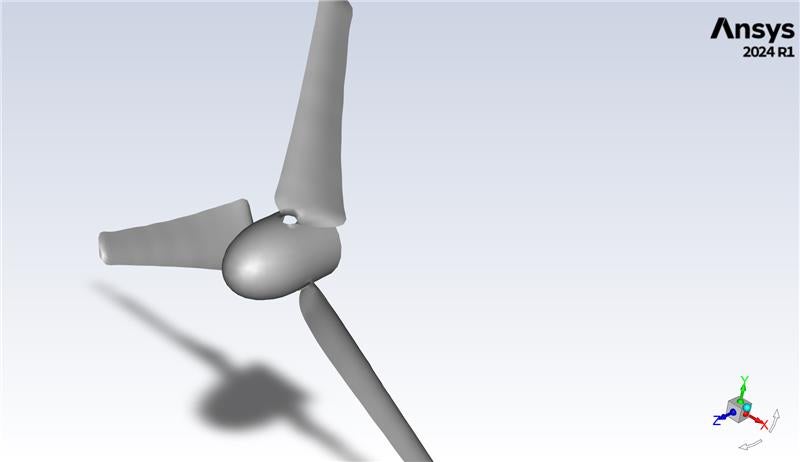

My problem is that when the disk covers only the part of the turbine that is supposed to be rotating (to the left of the slanted incline in the figure below), when the domain is meshed and imported into Fluent, only the back half of turbine_walls inside the rotating disk are correctly assigned as walls:

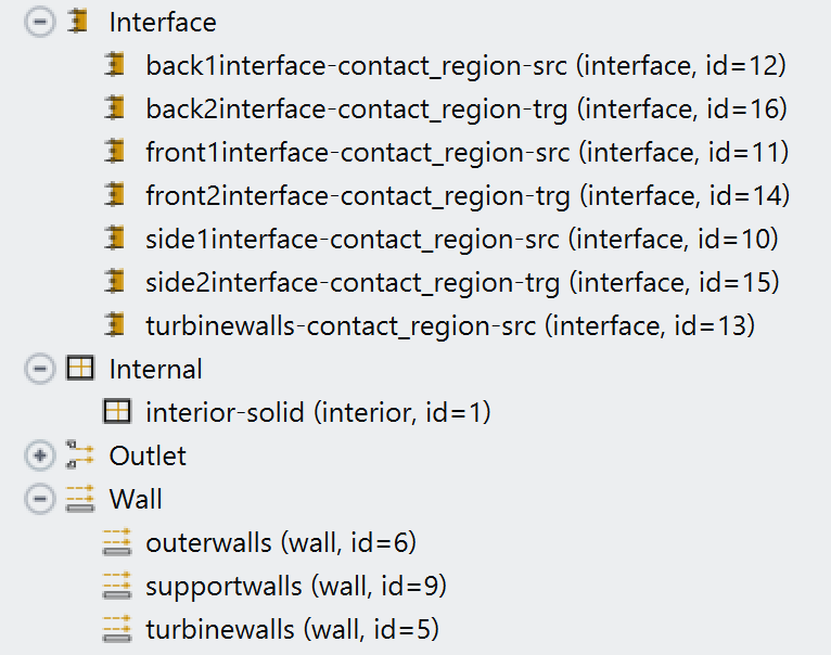

The front half is initially assigned as an interface and is automatically called turbine_walls-contact_region-src. I deleted the auto-generated Mesh Interface and assigned my own interfaces based on the disk faces, and Fluent let me reassign turbine_walls-contact_region-src as a wall:

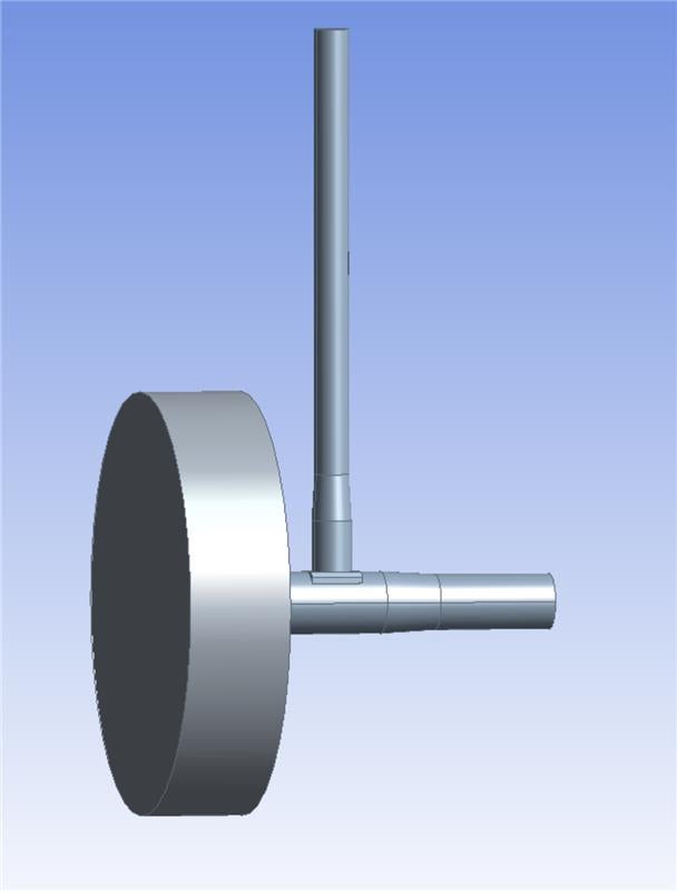

I have tried increasing the diameter of the rotating disk and extending it further to the left with no change. If I extend the rotating domain to the top of the slanted incline, as shown below, I do not get this issue as Ansys does not split turbine_walls into an interface and a wall:
This is not a permanent fix as the slanted incline is not supposed to be rotating. What could be causing this? The geometry is imported from SolidWorks and processed using DesignModeler, and I'm using Ansys meshing (although changing the mesh does not seem to have any impact on this problem). How can I remedy this?

SubscriberThanks Rob. There are interface pairs for each set of faces with 100% overlap, and the cylinder has mesh in it around the turbine walls. However, the walls surrounding the turbine void are the problem, as they are split in two and one half is assigned to be an interface:
Any idea how to stop Fluent from automatically creating that turbinewalls-contact-region-src interface?

Forum ModeratorAh, it's thinking the front & back of the blade are a contact zone? In Ansys Meshing look in the contact pair list. Find the one that's for the blades and delete it. You've tripped a "helpful" setting to autogenerate contact regions that's based on a tolerance. Your domain is big enough that the two sides of the blade are close enough together to be picked up.
