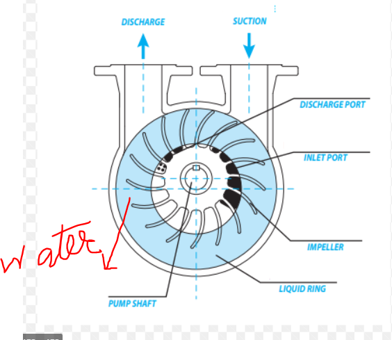

SubscriberIam currently trying to solve and study the Flow simulation in the LIQUID RING VACUUM PUMP .Â
Iam stuck as Iam unable to define the WATER in the ANSYS ( as shown in the Image ) .ÂCould you please suggest the easy way to define the water ?Â
Ideally , few blases will always remian submerged in the water when the LIQUID RING VACUUM PUMP is not in running or at static condition. -

Forum ModeratorHave a look at the VOF multiphase model.Â
