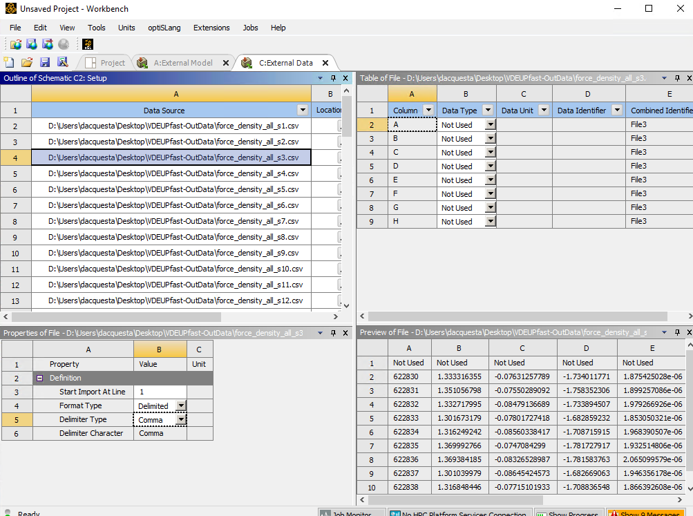

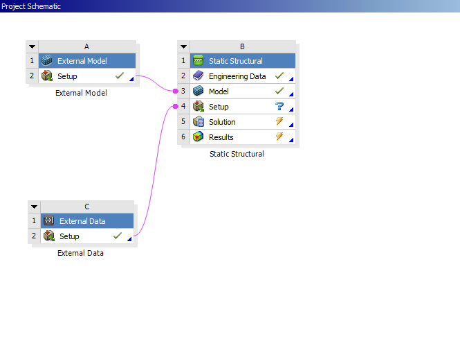

      Dears,
      I'm trying to assign at once the data type of hundred of files but without sucess. I didn't find a proper answer. I attached images of the question.

      GUI operations in Workbench are recorded in a journal file .wbjn.
      It should be possible to perform the operations for the first entry, then examine / edit / replay the journal to have the script edit the data types for you.

      Perhaps this is of help .
      https://developer.ansys.com/blog/script-tip-friday-automate-imported-loads-set-wb-scripting

      Expand the 'Data Source' window (upper left) so that you can see the rest of the columns.  D can be used to set one of the files to be the controlling file.  Set that files colmns/data types and when imported all the other files should follow the same mapping of the columns.
