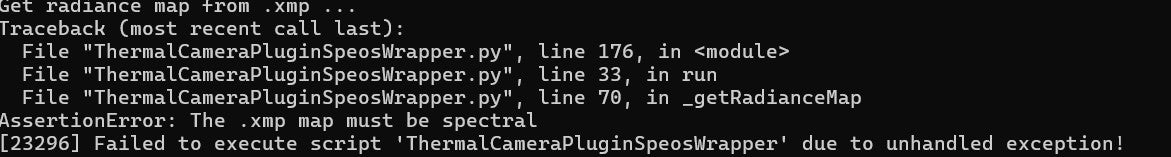

AssertionError: The .xmp map must be spectral
    • k.ranjan
      The screenshot of the execution error while using ansys speos camera wrapper batch file for temperature mapping.

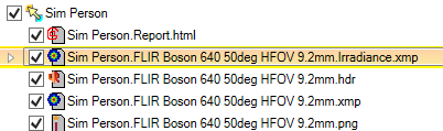

      Hello k.ranjan,
      Thank you for reaching out to us. That execution error you're encountering may indicate that the incorrect XMP map is being used. When saving Speos simulation results, please ensure you're using the .Irradiance.xmp file in the batch file for temperature mapping, not the .xmp file one.

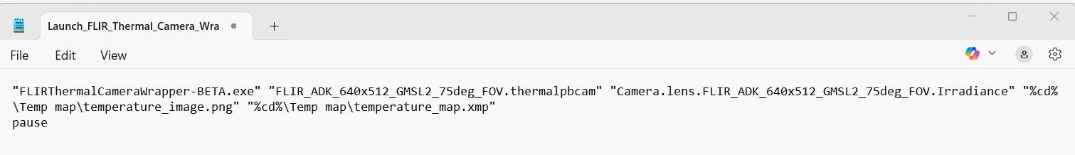

    • k.ranjan
      Hi Laura,
      Thank you for your response. I'm using the same. Irradiance.xmp file for conversion and referred to the same article, but the error still persists.Have a look on my batch file. Kindly help.
      • Laura Martín
        Hi k.ranjan,
        The file extension ".xmp" for the irradiance map is missing, the correct name to have in the batch file would be: "Camera.lens.FLIR_ADK_640x512_GMSL2_75deg_FOV.Irradiance.xmp". Please let me know if this modification solves the issue.

    • k.ranjan
      With that modification also, I have tried and I'm getting the same error: "The .xmp file must be spectral."
      Kindly suggest what to do next. Is there anything related to file location or something else?

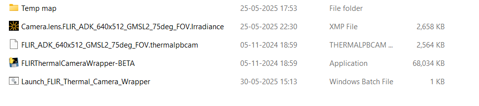

        Hi k.ranjan,
        If after saving and executing the batch file with this modification the error persist, I would recommend reviewing the path for every file included in the batch file. Please note that, with the path you are using, both the Irradiance XMP map and the .thermalpbcam must be in the same folder as the batch file.  Also, the directory (or folder) for the generation of .png and .xmp temperature maps should be already existing (please see the example I attach bellow for other thermal camera).

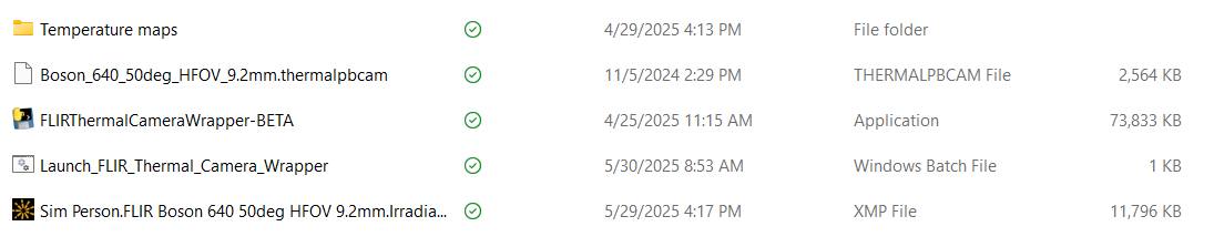

      It is showing that we are not eligible to take direct help from Ansys customer support. Could you please tell me how you can support me through the forum?
      Have a look at my format in which I kept the file.
