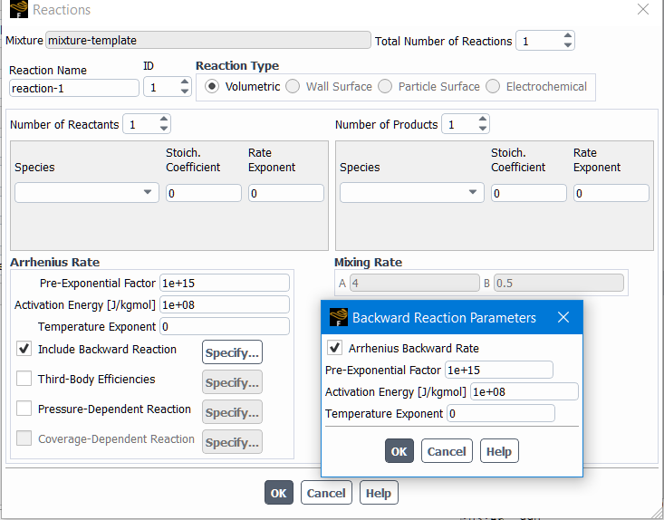

Reactions with = or <=> between products and reactants have forward and reverse rates. => indicates forward rate only.
If you enter a reaction manually, the forward and backward rates must be specified directly.
