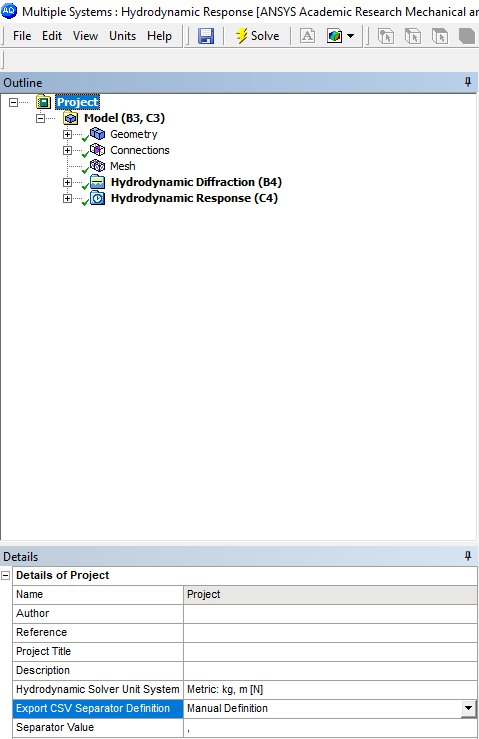

September 23, 2021 at 12:55 am
Jezza
Subscriber.Another much too late response, but could help someone in the future. If you are running Aqwa from Workbench, you can specify the seperator value for csv files. Select project, change export CSV Seperator Definition to Manual Definition and choose a value. See the image below.
