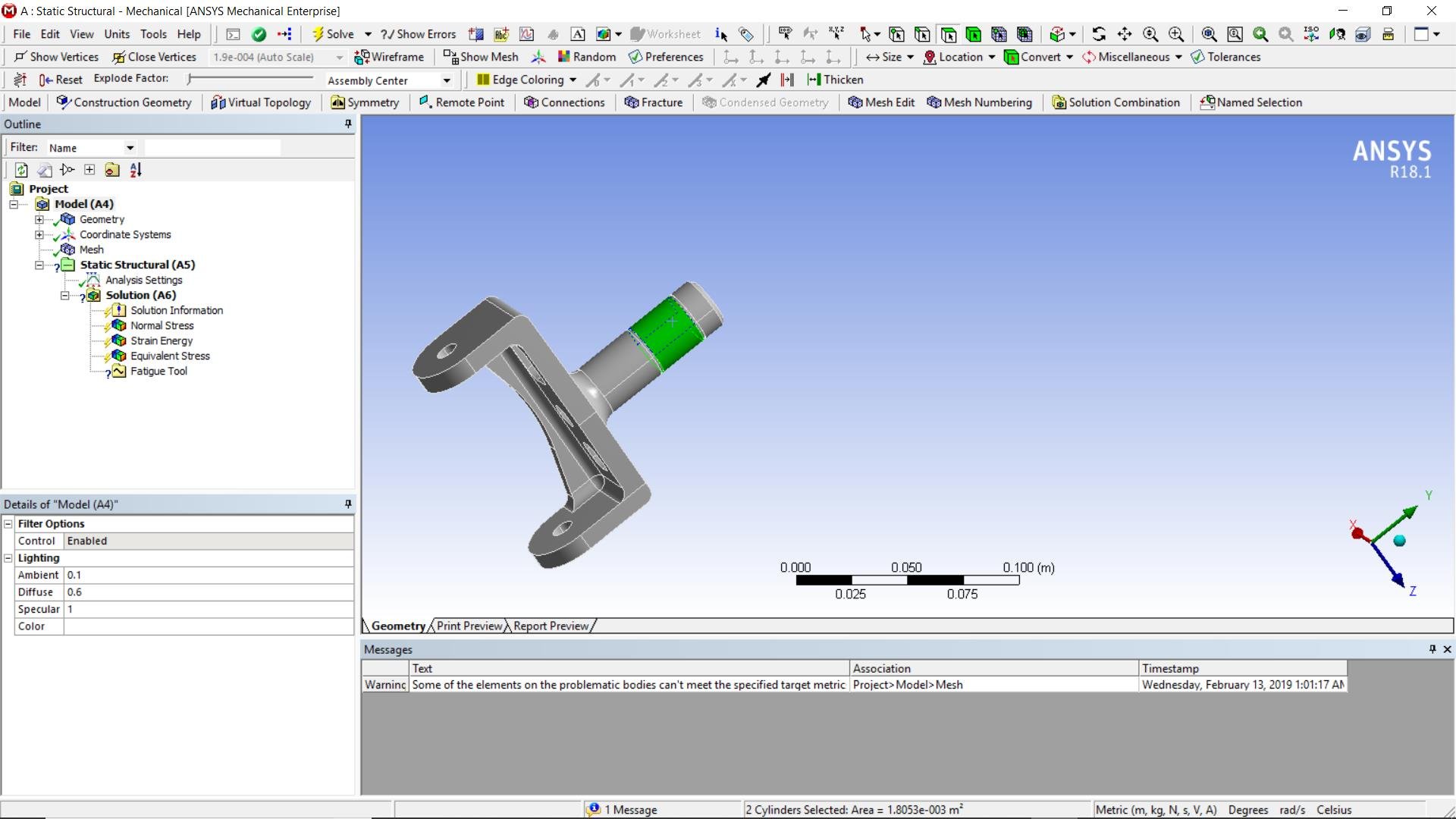

      I want to apply forces on a region of my upright geometry at the place where bearing is mounted. How can I select the cross section and apply load on it
      Use DesignModeler, create a plane at the desired location and use it to Slice the geometry into two bodies, then select the two bodies and Form New Part to create a multibody part so you don't need bonded contact. Now you will have a surface and an edge where the bearing is mounted. You can even put two planes close together to make a surface for the bearing seat.

      This is my bearing seat and i want to this.My whole load on vehicle will transfer from tires to the upright through this bearing.so I want apply load on this bearing mounting so how can i do this.

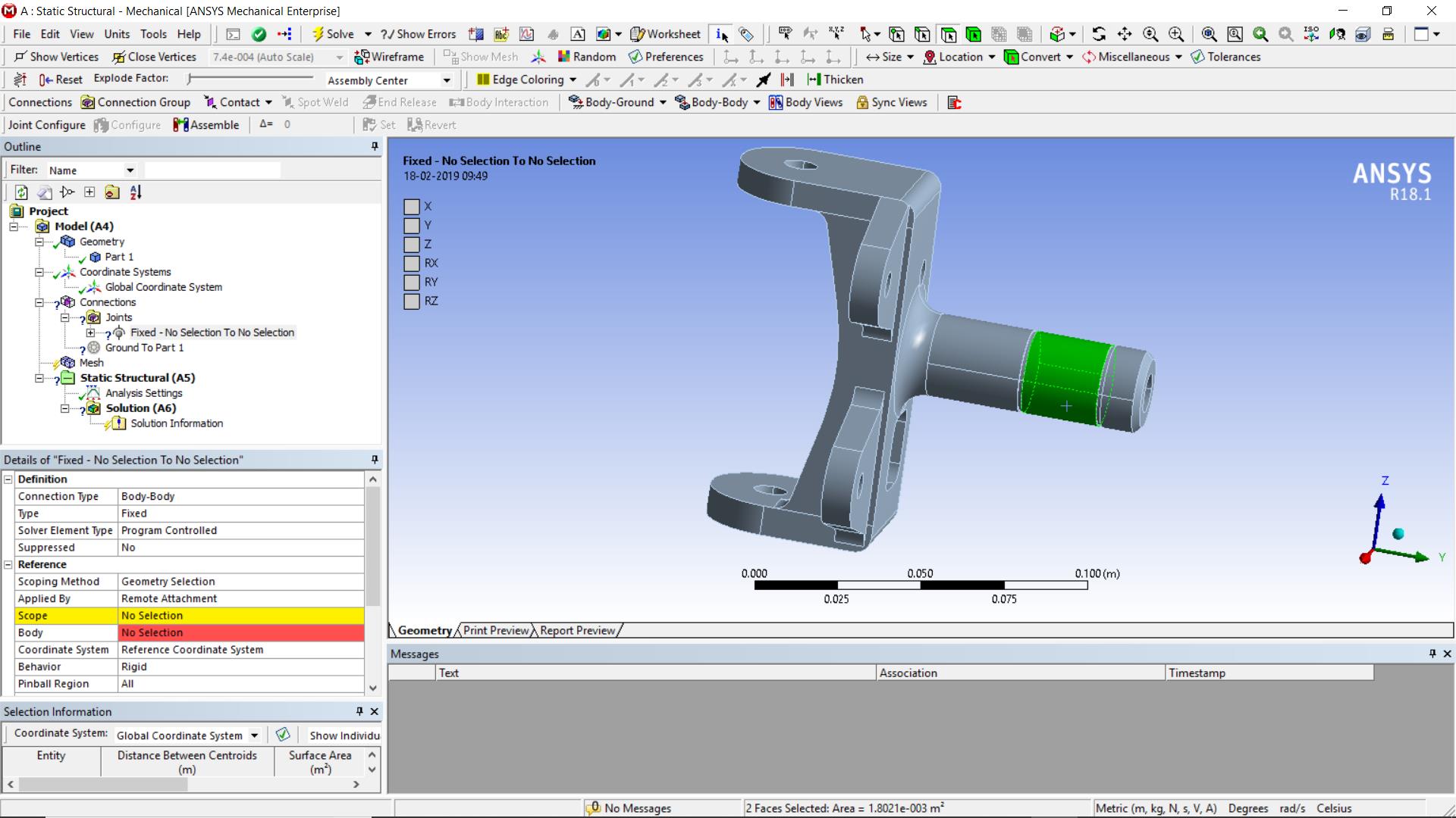

      I have two  bearings  here on this upright which are connected to hub which is connected to my tire,my upright is staionary.hub is rotating over this bearing.My forces from tire are transferred through this bearing.

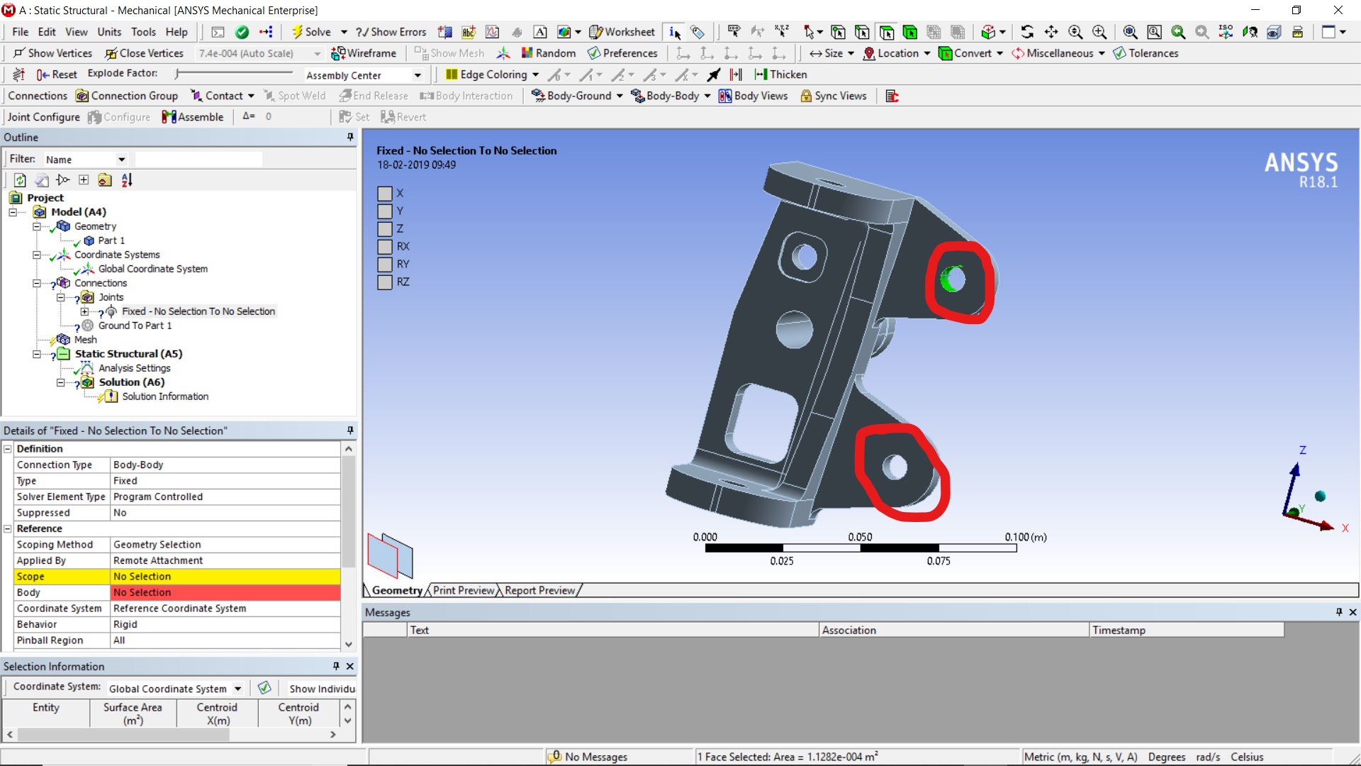

      I have a brake  calliper connected via bolts at this two marked holes.my calliper is connected to rotor which is rotating.calliper is stationary. I have not imported the geometry of calliper as it is a different part so how can show that there is a connection by using 'joints'. cause in joints i have to specify stationary and mobile surfaces.

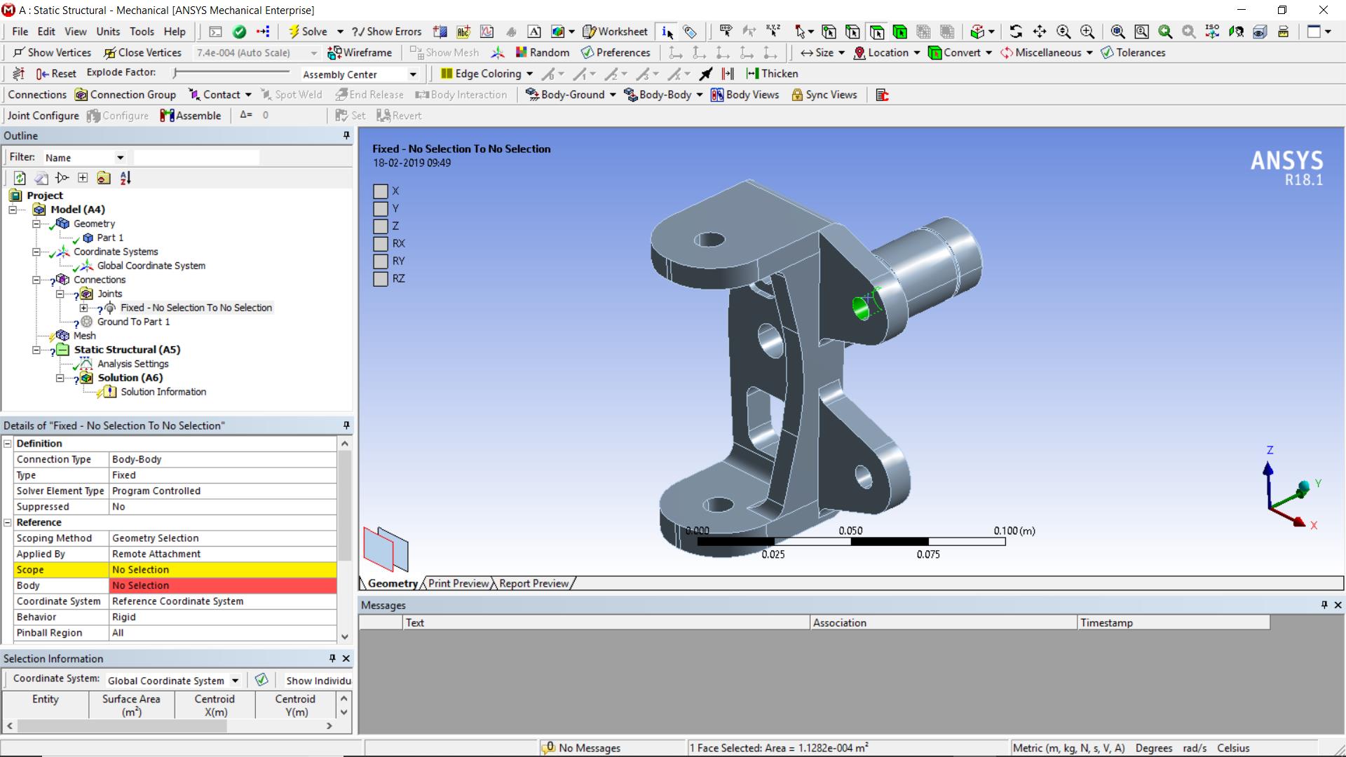

      I have a upper controlling arm connected to upright using ball joint at the top face similarly a lower control arm at the bottom face.
      So how can i show all these connections without importing whole assembly as I just want to analyse my this part??
