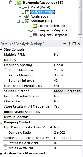

      An efficient way to do this, if you can accept a linear model, is to create a Modal analysis and drop a Harmonic Response onto the Solution cell of the Modal. That will allow you to apply an Acceleration as a Base excitation on the Fixed Support. Just convert the displacement specification of +/-0.4 mm at 30 Hz to the equivalent 14.2 m/s^2 acceleration. In the Analysis Settings, specify the frequency range, for example 25 - 35 Hz with 10 steps.

      However, I applied what you explained above and I don't know why I'm not getting the results as amplitude.
      The attached photo show what I did.
      Hamzah

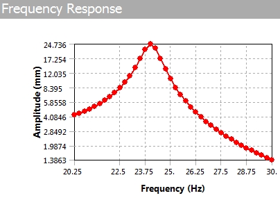

      Pick a vertex on the geometry where you expect to see a significant response. In the Harmonic Response system, under the Solution Branch, insert a Frequency Response for Acceleration, Velocity or Displacement. That will generate an amplitude of response vs frequency plot.
    • HamzaBaqasah
      Hi Peter,
      Thanks for your reply I could find the amplitude but it's not reasonable may be due to my inputs.

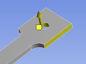

      Could you please the first image that shows my inputs in acceleration details? also, in the second image, the arrow is only directing to the top where my shaker is going up and down.

      What is the displacement result?  What do you think is a reasonable value?

      The amplitude value is very high compared to the length of the beam.
      Second, the arrow is only directing towards the top. I don't know if it's okay since I want to simulate the shaker where it moves up and down.

      The acceleration arrow direction is for up and down along that axis.
      Your model has a mistake, the acceleration is 14.2 m/s^2  You typed 12.4 mm/s^2.

      The amplitude is high because you did not include any Damping in the model.
      You have to enter some amount of damping, say Damping Ratio = 0.01 = 1%
      With 0% Damping Ratio, there is a 267 mm displacement at the tip at 24 Hz.
      With 1% Damping Ratio, there is a 48.7 mm displacement at the tip at 24 Hz.
      With 2% Damping Ratio, there is a 24.7 mm displacement at the tip at 24 Hz.
      Keep in mind that this is a linear analysis. When the deflections get too large, the small rotation assumption in the linear model is no longer valid. In that case, you have to perform a Full Transient and turn on Large Deflection in order to see the true deformation.

      I just need to know the amplitude when running it at its natural frequency and I think this gives me an idea especially when I want to compare it with another same geometry but has higher crack depth.
