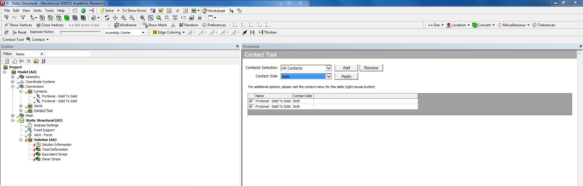

      Under the Connections folder, Insert a Contact Tool and Generate Initial Contact Results. Check to see that all the contacts are closed.  If not, change the Contact to include Adjust to Touch.

      I have the coefficient of friction set to 0.2, should it be 0?
      Also, there is the results of the contact tool.
      Is there any way I could manage to share my file so that you could have a look at it if possible?
      Coefficient of friction should be 0.2 not 0.
      After you Insert a Contact Tool in the Connections folder, expand the Contact Tool and there will be Initial Contact Status. You have to RMB and Generate Initial Contact Status, then there will be a table in the Worksheet.

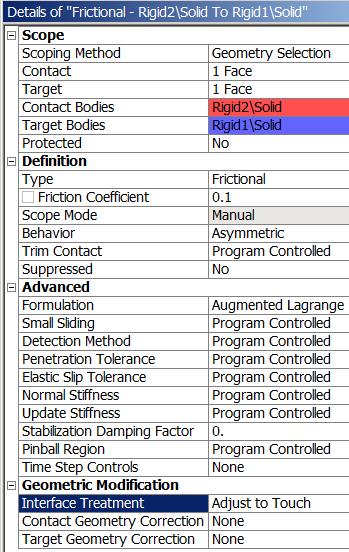

      My contacts are infact open, but I cant seem to find the "adjust to touch" selection?

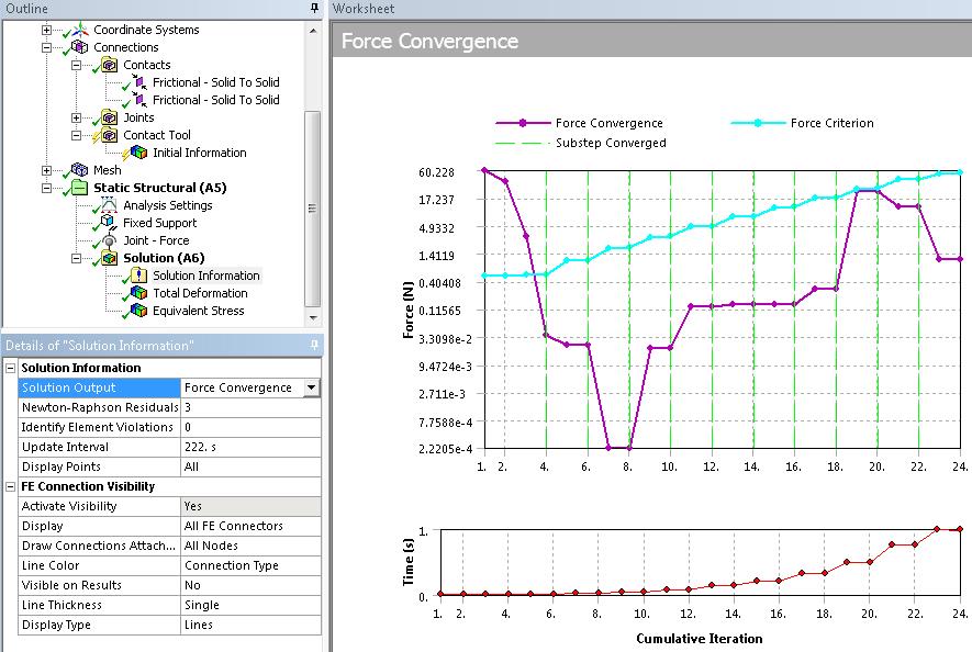

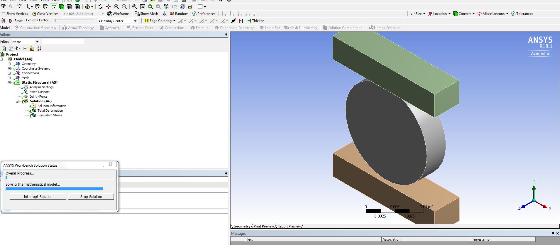

      I changed the interface treatment to "adjust to touch" to close my connections. Now, the simulation seems to take forever to solve as it has been stuck (see picture attached) for the last 5 minutes.
      The file you uploaded did not have the Adjust to Touch change made in the two contacts, which were open.  I made that change and a few other small tweaks. Once you hit Solve, you can monitor the progress by clicking on Solution Information and picking Force Convergence instead of Solver Output. Then you will see the graph below being plotted a point at a time.  That is a good way to know the solution is making progress.
      The solver needed 24 iterations to apply the full load from the 100th starting step. If you solve again, you can try to replace the 100 with 20 and it might reduce the number of steps needed to get to the full load (Time = 1 s).
      The wait time for the 24 iterations depends on the size of the model and the number of cores you are solving on. If you use quarter symmetry as I suggested above, you will cut your wait time to a quarter. If you use a rigid surface instead of a steel block, you will cut the wait time further. This full model took 5.8 minutes solving on a 15 core computer and 9.6 minutes on a 4 core computer. The solver needed  6 GB of free RAM to solve it without using the HDD. If you have a 2 core computer with only 4 GB of RAM, it will take more than 15 minutes. You can see the Elapsed time if you flip back to the Solver Output and scroll to the bottom.

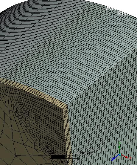

      Looking at the Stress results, you can see that you don't have small enough elements to capture the true solution, which is peak stress below the surface.  The coarse elements you have show the peak stress at the surface, which is incorrect. Smaller elements are going to increase the wait time for the solution. You don't need small elements all through the solid, just at the contact points. This is where the sizing mesh control Sphere of Influence is useful.
      Peter
