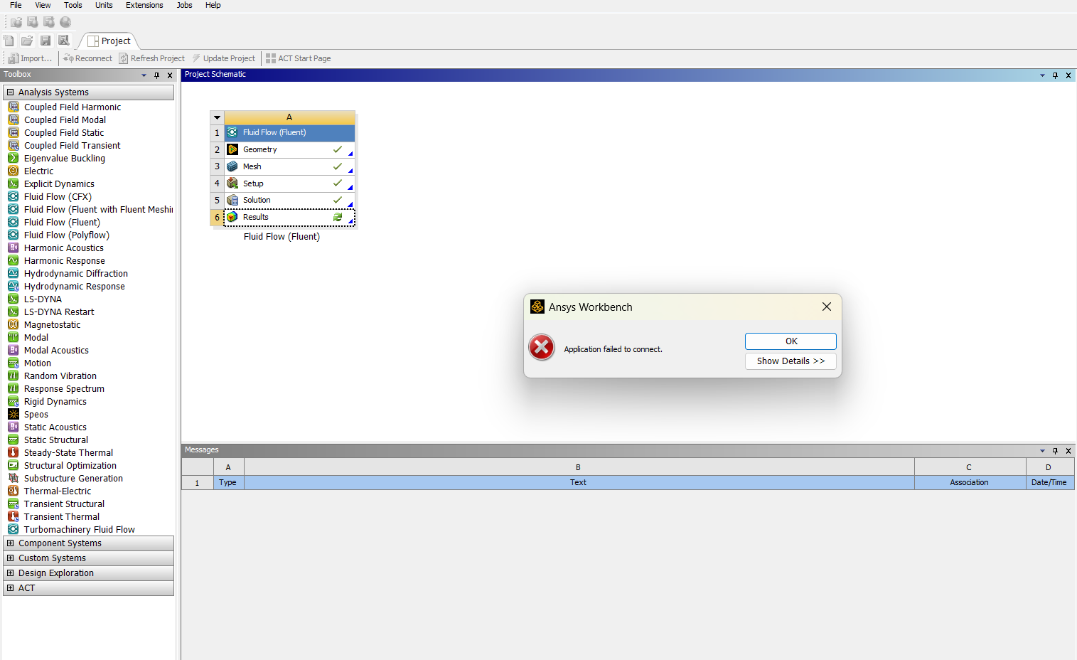

      I have a problem every time I reach results in Ansys fluent I get the " Application failed to connect " error.
      Can you help me solve this error? (Ansys Student 2023 R2)

      Hello Tarek,
      Was the installer downloaded from the Ansys website?
      Can you try:
      1. Go to "C:\Users\< username>\AppData\Roaming\Ansys" and rename the Ansys folder to Ansys.old
      2. Check if the graphics card & drivers are updated, you can go to https://www.nvidia.com/Download/index.aspx?lang=en-us to update NVIDIA graphics drivers.
      3. Reinstall a fresh setup
      Do let me know if this helps.
