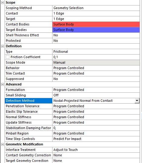

    • suleyman41
      Thank you for answer, but result is already false. In ANSYS APDL I have different result with Workbench. Also my APDL result is compatible with experiments.
      My workbench contact properties
