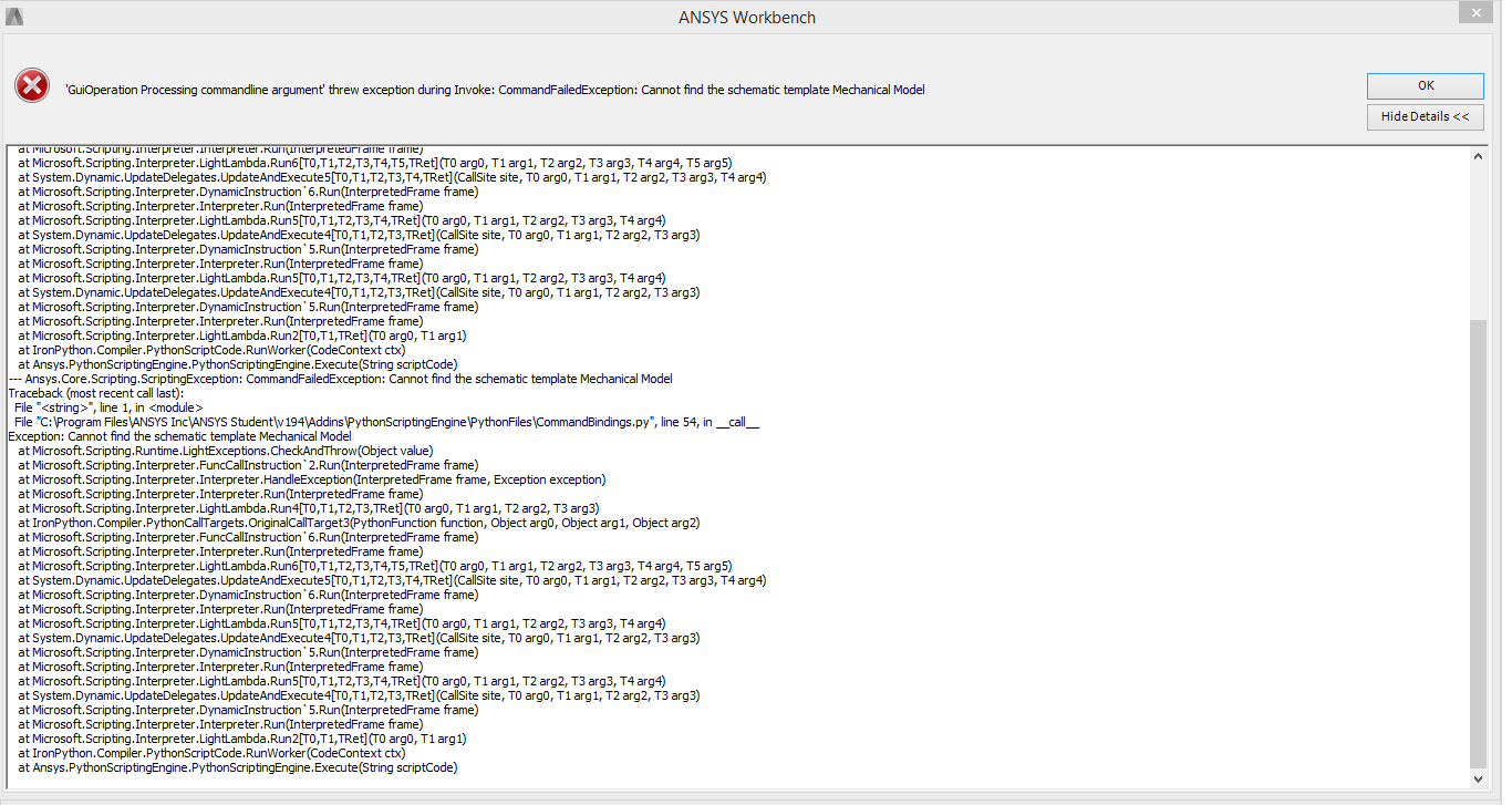

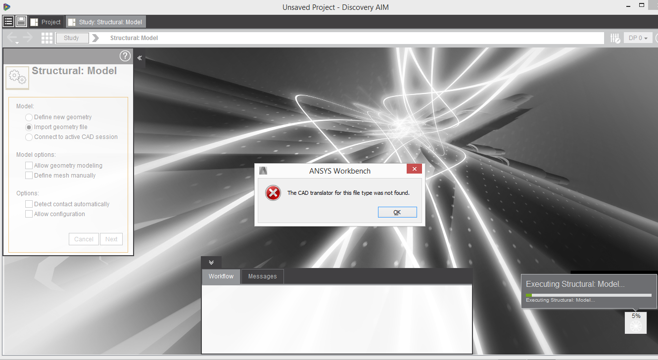

*I tried to import Solidworks model file in AIM.. it is showing message - - need to be CAD translator refer error image

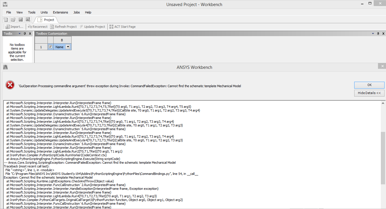

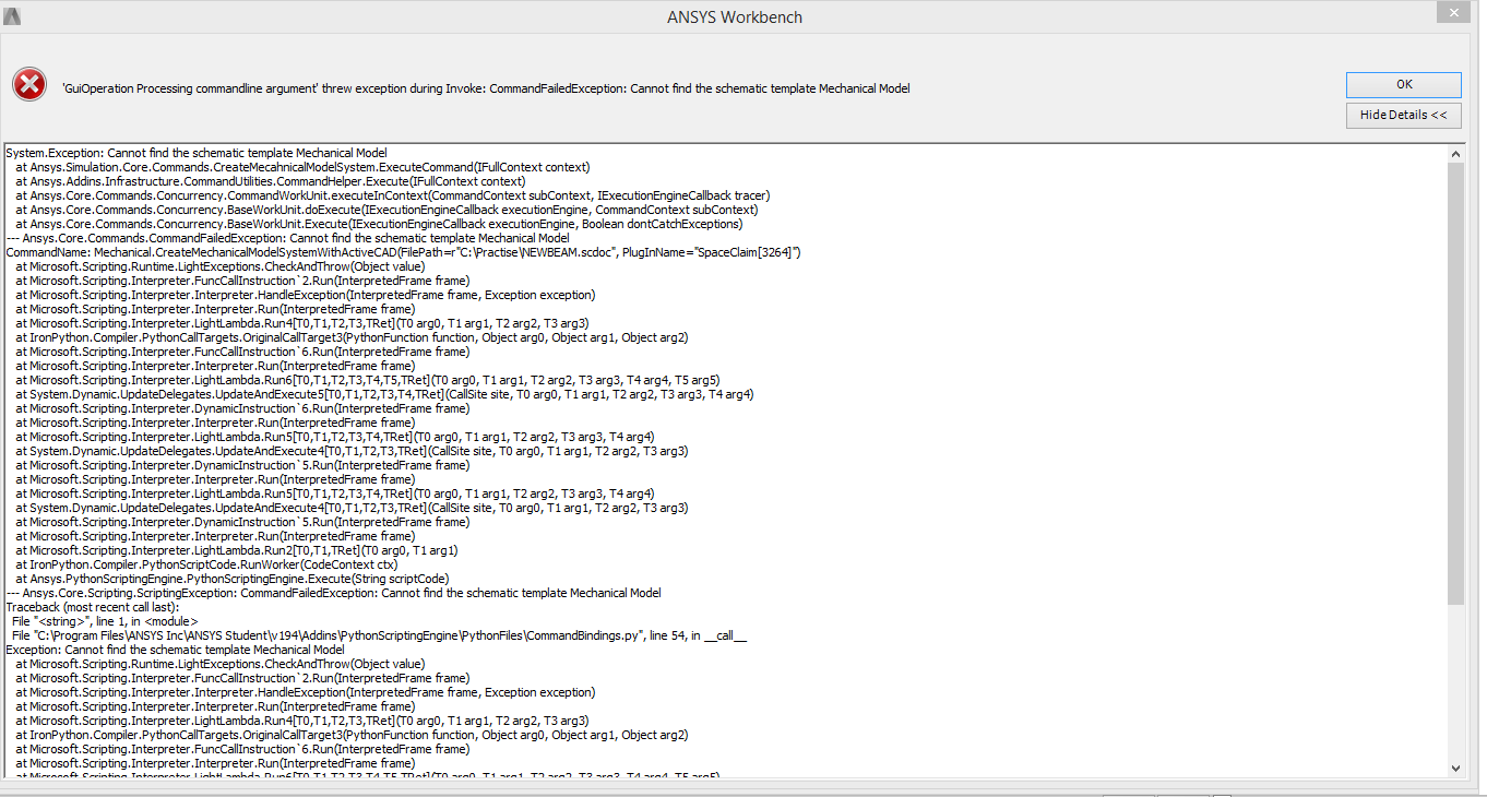

*I import solid works file successfully in Discovery Claim.. Then switch to Mechanical static Structural analysis... It got hanged
*Find attach image file showing the error message in workbench and mechanical , when we switch over from discovery space claim cad file

The questions you have posted can be categorized into Discovery related queries and queries related to ANSYS flagships. Please note that for flagship queries, student community is the platform to be used. Hence, IÂ can only revert to the discovery queries here on the forum.
As mentioned here, Discovery AIM Student only supports neutral formats for import. Hence, I suggest you to convert your solidworks model into IGES or STEP format, which should then import into AIM without any issue.Â
If you are looking for a high fidelity analysis, Discovery AIM is most suitable but for quick design exploration, Discovery Live is more appropriate tool.
