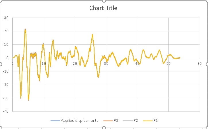

      Dear For first approach displacement at the base are Zero since my face is fixed. I am trying to figure it out but results looks strange since on each floor displacements are same over time do you have idea why is it?
      For later approach when looking at the results the deformations are almost same as the applied base displacements as shown in figure.
      Do you have Idea what might be wrong?
      Best regards
    • Sheldon Imaoka
      If you are plotting multiple points on your structure and they all look the same, that means that the structure seems to be moving rigidly together. Try solving a modal analysis to see if your frequencies of your structure are realistic.

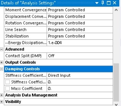

      1)I defined the density as usualy from material properties however I am using microplane model for concrete, I am now afraid the microplane model command is overwritting all properties or just the defined ones can you have a look to it?
      2)For damping I didnt changes any thing kept the settings as usual.

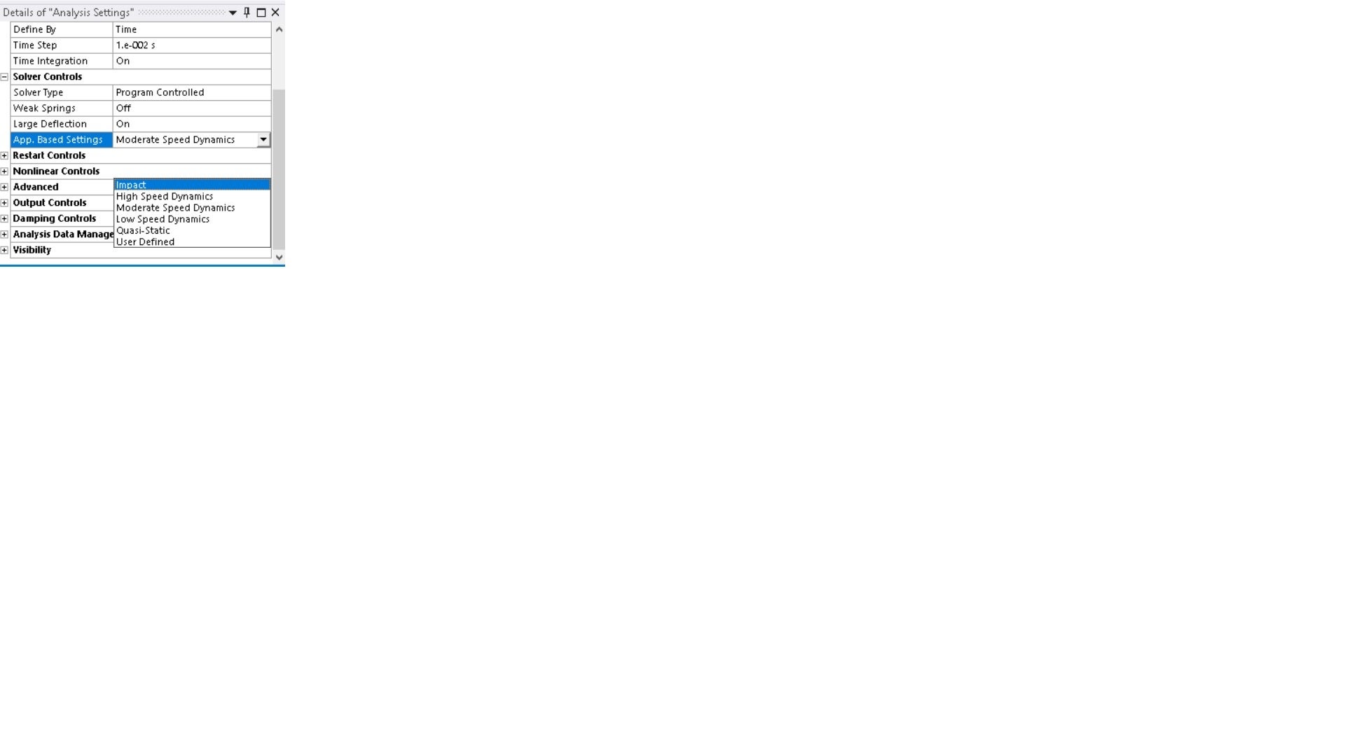

      3) For advance setting the default is moderate speed dynamics, does this matter and what should be used for seismic
      loading?
    • Sheldon Imaoka
      I cannot download any attachments, but please check that your materials are defined in the same unit system as you are solving.
      Try solving without the "Commands (APDL)" object first, using the same elastic properties. That will give you an idea if the "Commands (APDL)" object is the source of the problem.

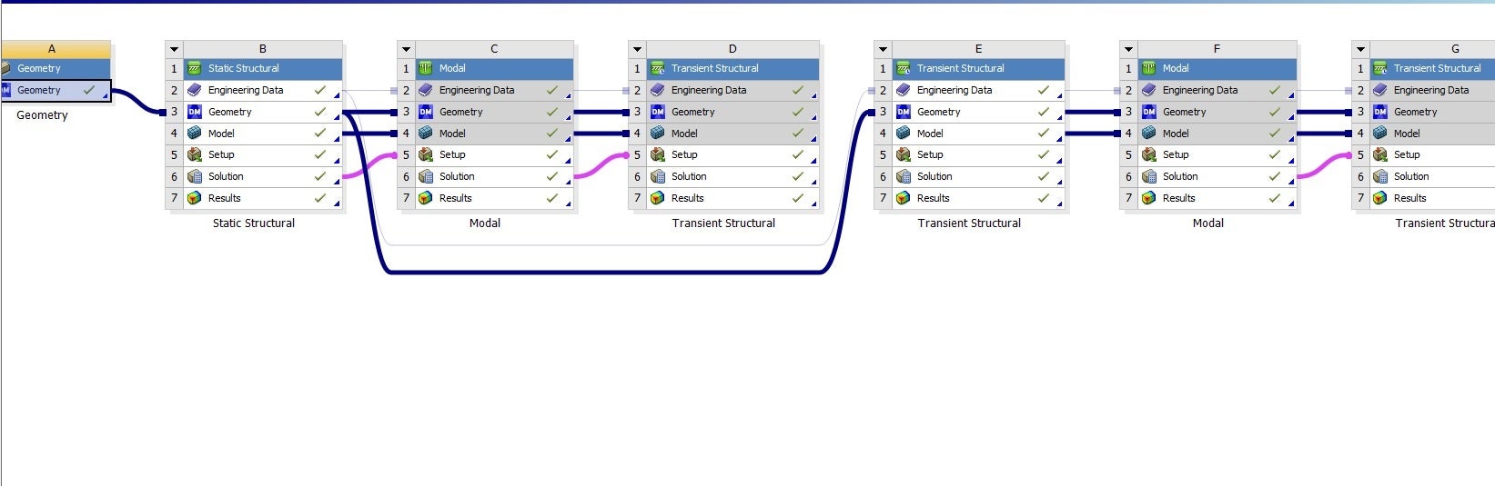

      I also performed time history analysis by Model superposition by following scheme (Static-model-transient), (transient-model-transient) but the rigid body motion is still there.
      Could you please help me what might be the problem with my analysis? Or can you recommend me any material? Since I searched a lot but could not find a single tutorial which is performing time history analysis by full transient specially for seismic loading.

      Thank you for the response By rigid body motion I meant the deformations on all floors are almost same.
      Yes those are the deformations along x-axis which are my interest since my loading is along X-axis. The time is in seconds, total timing of my earthquake is around 53.71sec.
