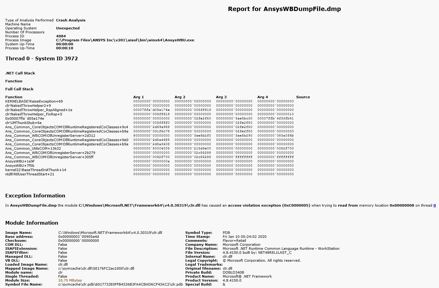

I am unable to mesh part in ANSYS R20. Every time I click generate mesh, I get an error "AnsysWBU.exe encountered a problem. A diagnostic file has been written" and the meshing window closes automatically. However, I don't get any errors while meshing in Ansys R19.2.Â

I also analyzed the DMP file and got the following message,
"In AnsysWBDumpFile.dmp the module C:WindowsMicrosoft.NETFramework64v4.0.30319clr.dll has caused an access violation exception (0xC0000005) when trying to read from memory location 0x00000008 on thread "

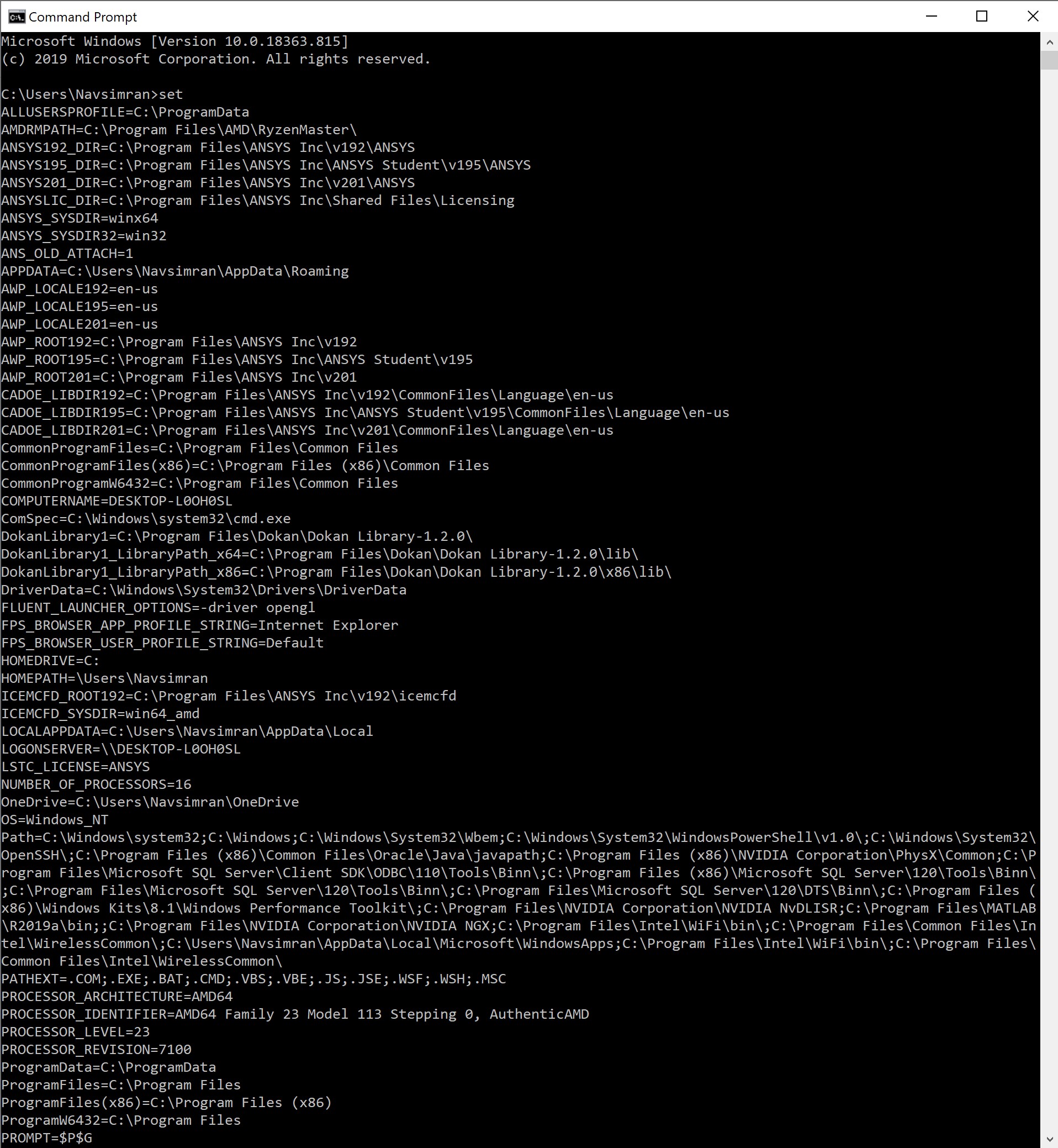

Ansys EmployeeOpen CMD Prompt, then enter this command
reg query "HKEY_LOCAL_MACHINESOFTWAREMicrosoftNET Framework SetupNDPv4Full" /v Release
and post the output of it here
Also, post the output of
set
command
