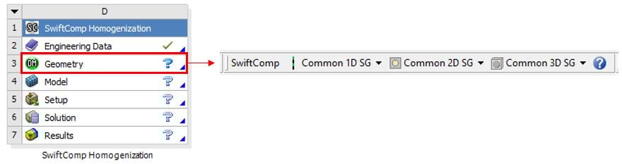

2.2. Toolbar in DesignModeler
In the DesignModeler, SwiftComp toolbar with Common 1D SG (Structure Genome), Common 2D SG and Common 3D SG will be available

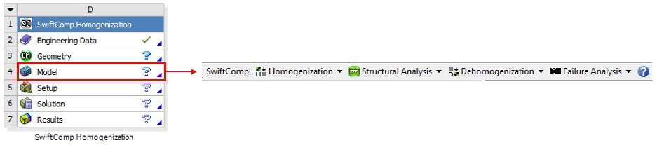

2.3. Toolbar in Mechanical Environment
In the Mechanical environment (Model), SwiftComp toolbar with Homogenization, Structural Analysis, Dehomogenization, and Failure Analysis is available.

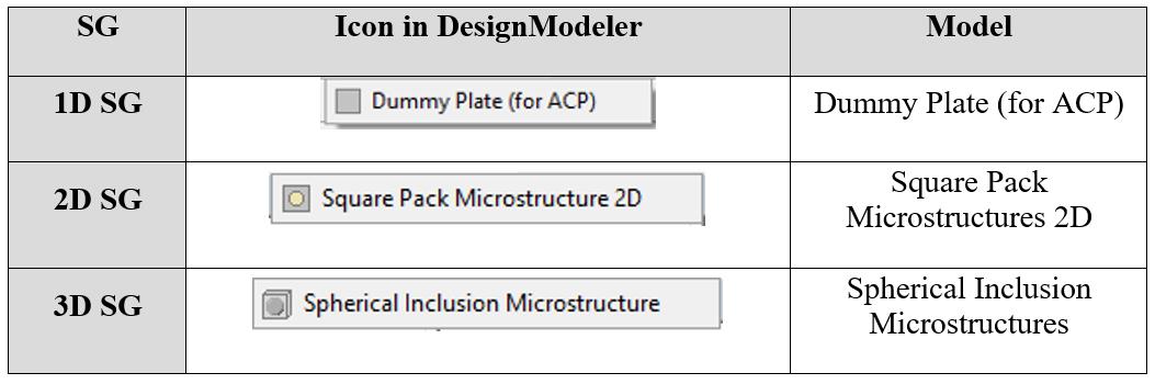

3. Common SG
ANSYS Workbench SwiftComp GUI provides a convenient way to create some common SG models in DesignModeler. Users can easily create the geometry of these models by input the parameters for these models. Currently, ANSYS Workbench SwiftComp GUI provides the following common SGs:

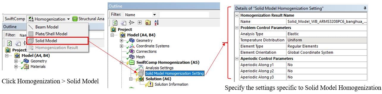

4. Homogenization
In homogenization analysis, constitutive modeling over the SG is performed to obtain the constitutive models needed for structural analysis.
For example, the figure below shows the homogenization for Solid Model.
