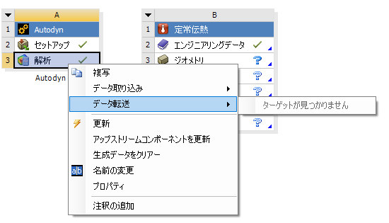

Ansys EmployeeAutodyn Component system in Workbench can only take the models from Explicit Dynamics systems. The model in Autodyn Compoenent systems cannot be transferred to other systems, including an Explicit Dynamics system.
If you have a model in Explicit Dynamics system, you should be able to link it to Steady-State Thermal Analysis system to transfer the model.
