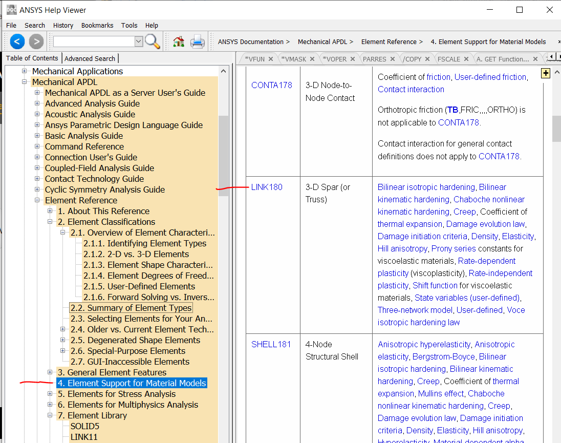

I am using ANSYS workbench to model a ligament using a spring element. but I am wondering if I can make a non-linear spring without manually putting the parameter for the force-deflection curve in COMBIN 39 element type. I noticed that there is an option for material type in spring properties but I am not sure if I place the non-linear material in spring properties in the COMBIN 14 (linear spring type), the spring behavior can appear as non-linear.Â
November 22, 2022 at 1:45 pm
Chandra Sekaran
Ansys EmployeeCOMBIN14 is linear only even if you define nonlinear material properties. I think the combin39 approach you mention is best.Â
