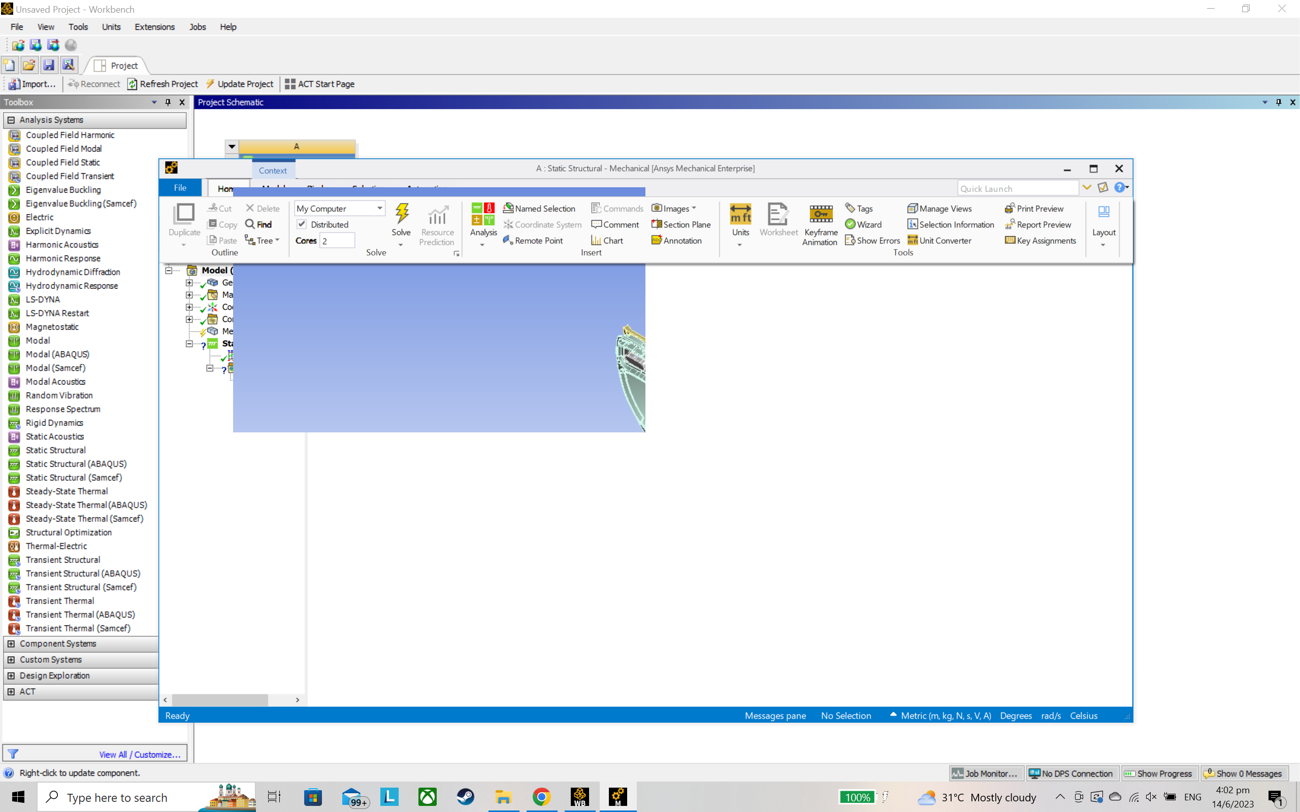

      My window layout for model has gone haywire and the reset layout function does not work at all. Can anyone help me with it?

      What version of Ansys Workbench are you using?
      What graphics card do you have? Please check the Nvidia website and install any new updates available and restart Ansys
      Are you using a 4k display?

        I am currently using Ansys Workbench 2021 R2 Teaching ver. and my laptop's graphics card is GeForce Rtx 3060.
        • VJ
          I do not see GeForce RTX3060 in tested/supported graphics card document for Ansys 2021R2. This could be the reason behind the glitch in GUI.
          Ref - https://www.ansys.com/content/dam/it-solutions/platform-support/previous-releases/ansys-2021-r2-graphical-display-graphics-cards-tested.pdf
          You can try updating the graphics card to see if it helps.
          or, try renaming the %appdata%\Ansys folder and relaunching Ansys again to see if that helps (resets config to default)
