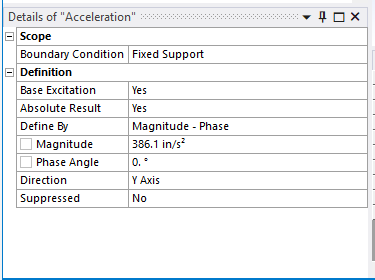

January 11, 2022 at 12:36 pmmsoffa
SubscriberI mean base excitation as in an acceleration being applied to all nodes including the constrained nodes of the model. It is available as an option in Workbench for acceleration loads:
I don't know if that's a newer ANSYS feature or not and I don't necessarily understand how it translates to the APDL world.

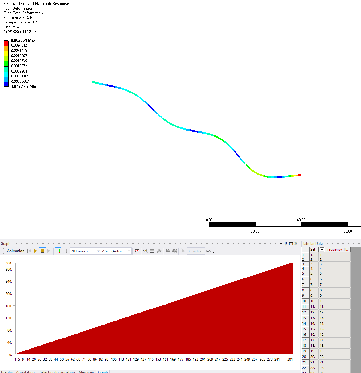

I didn't state this explicitly before but the outputs I am looking for are displacements. My model looks like this:
It is essentially a bunch of point masses connected to a shelf. The shelf is meshed with shell elements. There are about 65K elements and nodes. It is constrained at the bottom surface (3 faces, shown above.) I have a Modal system connected to a Harmonic Response system. The analysis settings for the Modal system are as follows:

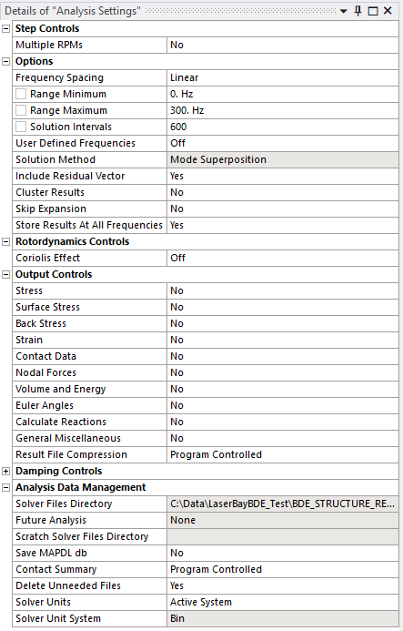

I was a little off in my estimate earlier, going from memory: 80 modes gets me results to ~ 350Hz. The linked harmonic analysis system has the following analysis settings:
The acceleration load is applied as shown above. (Before someone mentions it, the linear frequency spacing is necessary for my external post-processing...) If I switch "Skip Expansion" to "Yes", I get an error saying that you can't skip expansion with base excitation. I am making a guess that the implementation of base excitation requires the expansion pass? Otherwise this would be ideal. Can anyone explain why the limitation on base excitation exists? I have not tried doing the large mass method for base excitation but I am wondering if that's a possible workaround.
As I said earlier, I tried turning off the output requests as you can see above as I am only interested in the displacement solution. That did not seem to change much. I also tried limiting the scope of the output using OUTRES in a command statement. That reduced the results file size but not really the run time.

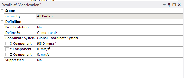

SubscriberWhat version of Ansys are you using? Are you possibly using an ACT extension? I am using 2021 R2 and what you have shown for the acceleration load looks completely different to what I am used to been using since 18.2 (~2017).
The acceleration load object does not have a Scope->Boundary Condition option, unless you are using Response Spectrum Analysis, but then the details windows looks different again. The Acceleration load details window looks as I have attached below, with "All Bodies" greyed out, as Mechanical is yet to support component applied acceleration loads (even though APDL has supported this forever).

SubscriberI am using 2021 R1. I think if you were to change "Base Excitation = Yes" your dialog box would look like mine.

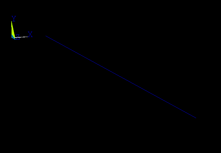

Unfortunately this result file does not open in Mechanical, and I am not sure why. The result file can be opened and post processed in MAPDL. I have attached a screenshot showing the enforced motion being visible in the results, the original fixed location of my beam was at the origin. For my test model, solution is in seconds, and the expansion pass is many minutes, so a considerable time save.

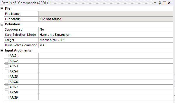

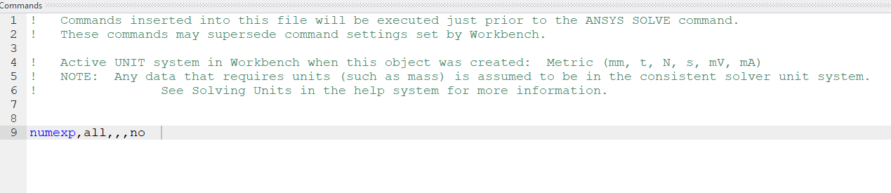

Subscriber***** a much better solution
add a command snippet to the Harmonic response
insert command numexp,all,,,no
In the details window, set "Step Selection Mode" to "Harmonic Expansion"
solution shows enforced motion. and takes only seconds to solve and write result file.
this doesn't technically skip the expansion pass, but tells the expansion pass not to calculate any additional results, so kind of the same thing

SubscriberI confirmed that this works in my model. Solve time goes from 6 hours to 10 minutes.
Thanks again!
