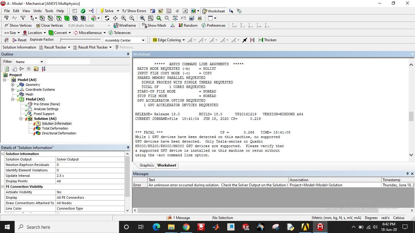

      I am using Ansys 18.0 since two years. After a year of helping me excel in my simulation work, Ansys is now not ready to solve the problems all of a sudden on the same PC with everything remaining the same (I havent even resintalled my Ansys till then).
      I have attached the screenshots of the error messages I receive along my with PC's specifications.
      Modal analysis on a simple cantilever beam
      Error line 1
      Error line 2
      My solver settings
      My solver settings
      When I change the number of utilized cores, the error just changes but that does not solve the problem.
      When I change the GPU to INTEL, the error becomes 'No supported GPU is detected'

      P.S: Ansys was running fine and solving complex problems on the same PC a year back. Now all of a sudden it does not work. Kindly help me with a solution or just help me how can I return without using the -acc command as shown in the error.

      In the Advanced Properties, change "Use GPU acceleration if possible" to None.
      Now, try to solve.

      That worked man! Thanks a lot!
