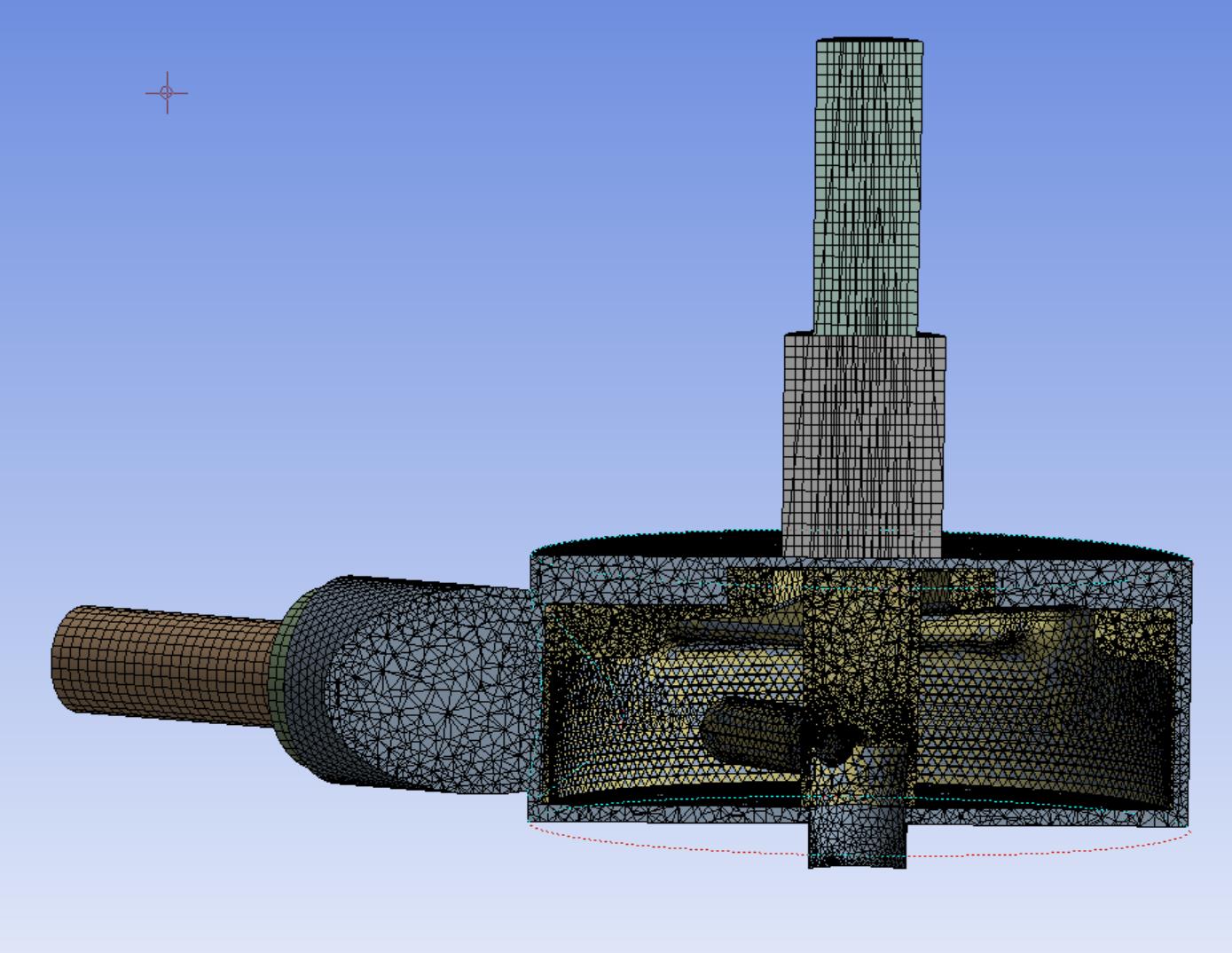

      So now my mesh is failing as well. Do you have any suggestions? Below are a few pictures of the mesh I created with the settings used. I also used a patch conforming method as well.
    • Keyur Kanade
      i think mesh is succcessful but translation to fluent is giving error.
      right click on named selection in model tree and select repair overlapping named selection. then try to export .msh file from mesh to fluent.
    • lianapolikaitis
      I was actually able to mesh finally using a different computer. I also created a new post about reverse flow. If you have any suggestions please take a look at the post and let me know!
