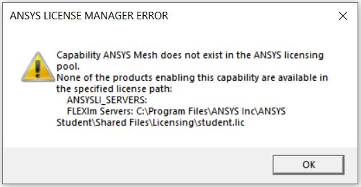

So I've been using ANSYS for month now and yesterday (suddenly between tasks) Workbench decided to disappear and ever since I have no access to f.e. Mesh, Fluent and many others. I've been scraping though many forums but haven't encountered solution. I'm using Student license and till yesterday everything was working just fine.Â
Done a lot of troubleshooting, including multiple reinstalls, cleaning every ANSYS related file off (as sugested in many threads posted in this forum) but none of these would help
Really need it to work for incomming projects
Any help would be most appreciated! Also, trully sorry for raising alarm not having looked for the answer long enough (in case such exists somewhere in here)!
Attaching some screenshots of the issue:

Forum ModeratorThe 2019R2 licence expired this week(ish) which version are you using? The licence manager can also fail due to Windows effects so rebooting is sometimes needed.Â

SubscriberI am using latest release of ANSYS 2020 R1.
