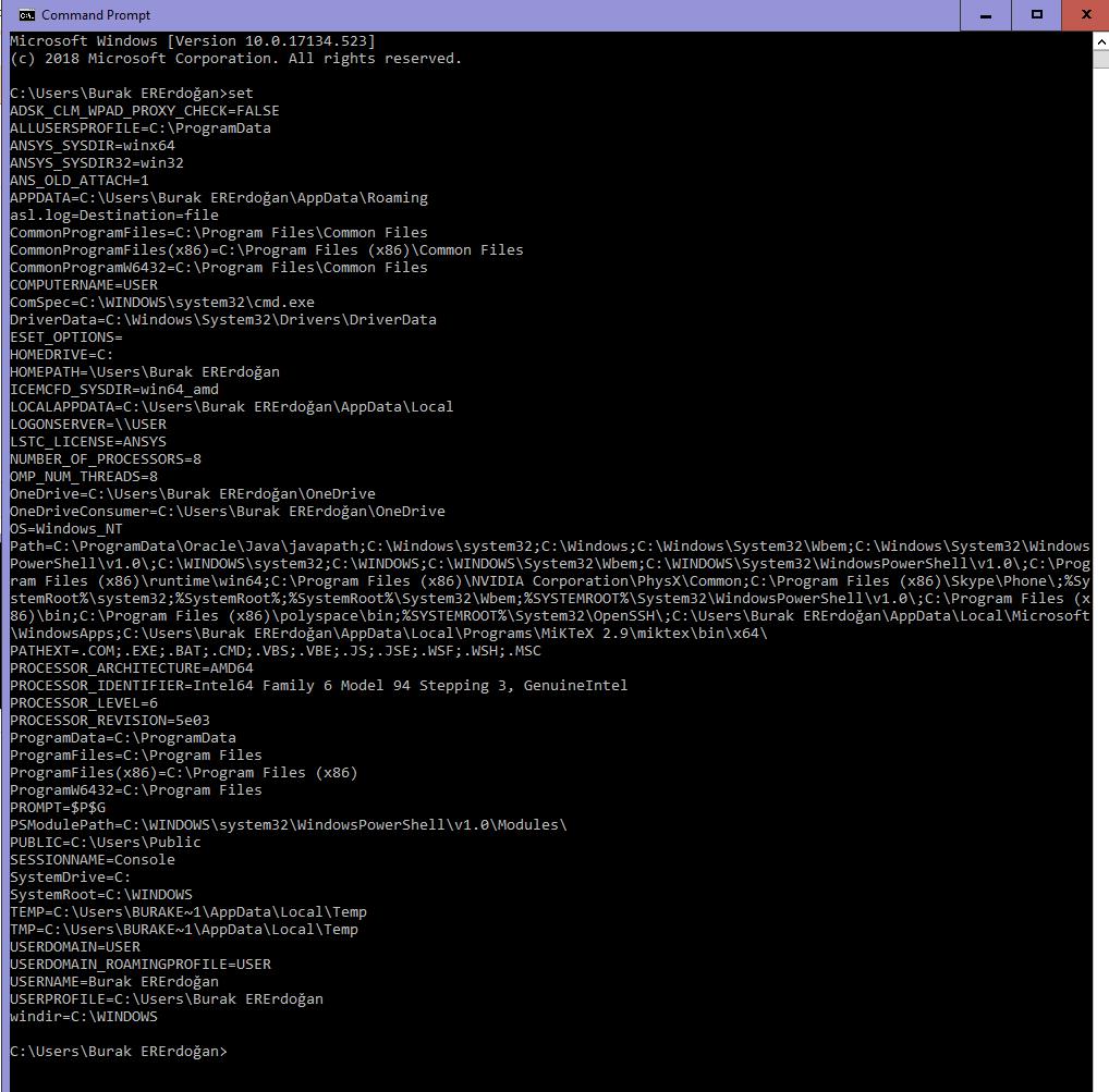

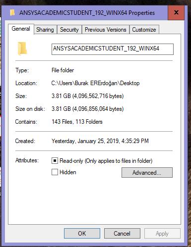

      please post screenshots of the following
      - output of the 'set' (without quote ' ' ) in your CMD Prompt
      - right click on your 'unzipped' installation package -> Properties

    • burakerdogan02
      Thank you very much,
