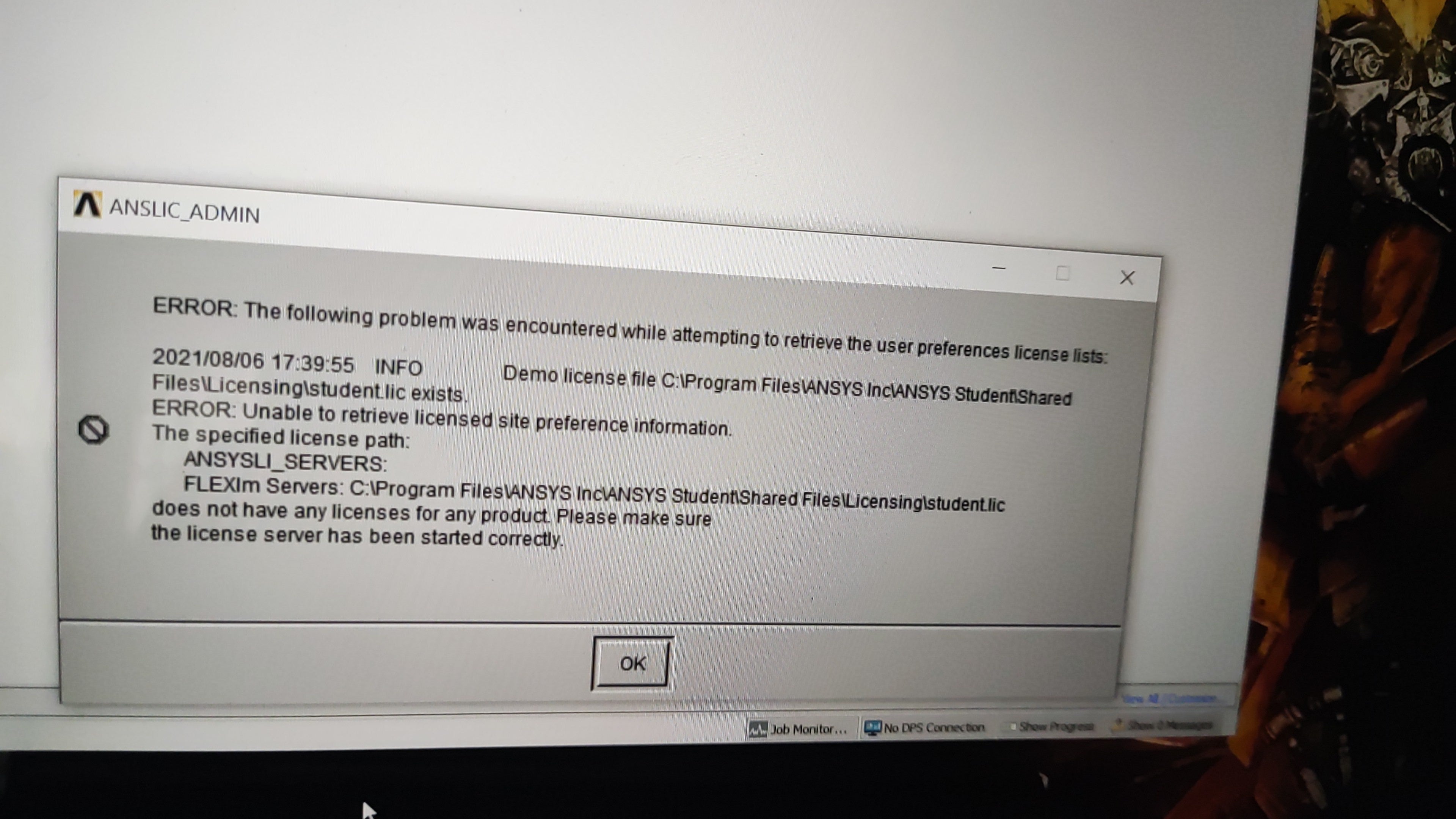

nikhilvarma
Subscriberafter installing 2020r2 student version i am unable to open mechanical apdl and even workbench and keep on getting the license error message so can any one help me with this i am helpless and its mandatory for me to use only 2020 r2 student version
August 6, 2021 at 6:52 pmANSYS_MMadore
Forum ModeratorPlease uninstall and then delete the entire C:\Program Files\Ansys Inc directory. Now redownload 2020R2 and reinstall.
August 6, 2021 at 6:53 pmnikhilvarma
Subscriberdid it more than 5 times but the same problem keep arising
August 6, 2021 at 6:54 pmANSYS_MMadore
Forum ModeratorOpen a Windows command prompt and type "set" without quotes and post the full output.

August 6, 2021 at 7:42 pmANSYS_MMadore
Forum ModeratorIf you completely uninstall and delete the C:\Program Files\Ansys Inc directory, then download the 2020R2.1 installer it will have a valid license to 1/31/22. When installed there should not be any license file in the C:\Program Files\Ansys Inc\Shared Files\Licensing directory, or reference to a file in that directory when running it. Please also try deleting your %APPDATA%\Ansys directory.
August 6, 2021 at 8:02 pmANSYS_MMadore
Forum ModeratorCorrection, there WILL be a student.lic file in D:\Program Files\ANSYS Inc\ANSYS Student\Shared Files\Licensing, with an expiration of 1/31/22.
