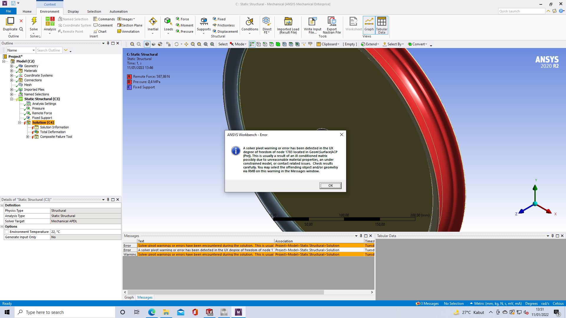

I'm working on ANSYS ACP - Static Simulation Carbon Fiber Wheel Rim but a message appear like this (Image 1):
"A solver pivot warning or error has been detected in the UX degree of freedom of node 1783 (Image 3) located in Surface Body. This is usually a result of an ill conditioned matrix possibly due to unreasonable material properties, an under constrained model, or contact related issues. Check results carefully. You may select the offending object and/or geometry via RMB on this warning in the Messages window."
I don't know where the problem is. If it's the geometry, I attach my geometry faces on (Image 2). I also display my boundary conditions on (Image 4). I used ACP Prepreg on this simulation.
Please help, I'm new on Ansys.

January 11, 2022 at 7:40 amErKo
Ansys EmployeeHi
There are many posts on this type of warning/error - search this forum.
One post that is very helpful and describes what it means (pivot) and what the possible issues causing this is:
All the best
Erik
January 15, 2022 at 9:25 amlatereport
SubscriberThank you so much Erik for the reply my problem solved. Turns out it was caused by me not enabling share topology.
