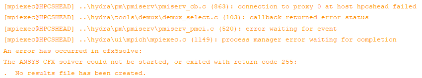

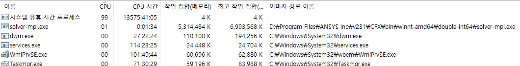

      • shin7
        OS is Windows server 2016.
        At first sover-mpi.exe is normally working.
        A few minutes later.
        I got this message!
        This problem is based on old Intel mpi version.
        I already reported these problems to ANSYS many times!

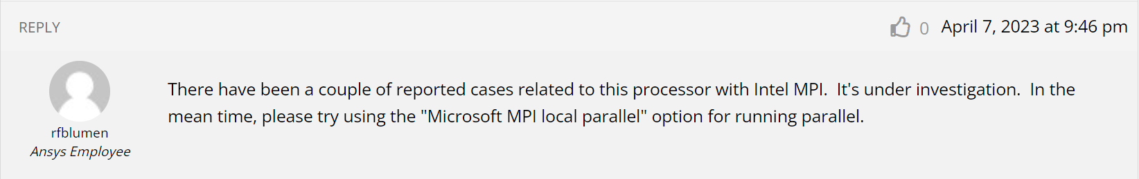

      • shin7
        your colleague's reply is....
