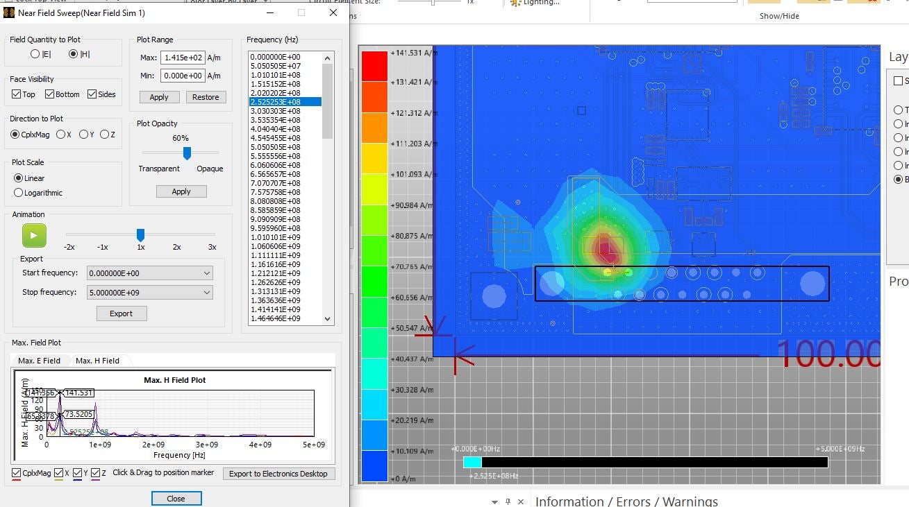

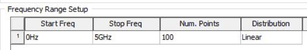

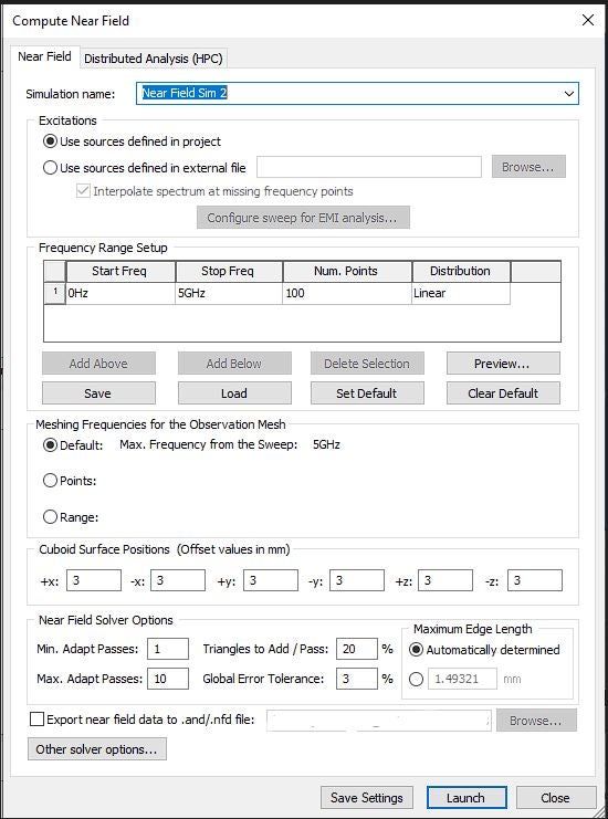

SubscriberI installed a simple pcb on ansys siwave. I defined the power lines. And I defined an ideal voltage source that gives only 18v on the pins. I set the near fields analysis as you can see.
interestingly, in near field scanning, I see magnetic fields occurring at 200mhz and 900mhz. How is this possible in a DC power supply? Is the simulation giving an erroneous result or is there something I missed?(note that I only added a dc voltage source, no current source or oscillating signal lines)

Subscriberyes, I am aware of this. as I understand it only scans the near field reflected from the system, it does not apply any frequency to the system.Near field “scanning” test helps us to see the magnitude and frequency of the magnetic field in the determined frequency range.It allows us to make a measurement from the close region, not exceeding the full wavelength of the wave emitted from the system. There would have to be an oscillating source for me to see such a result. But there is only one dc ideal source. What I expected was that I only saw a magnetic field at 0Hz, that is, in the non-oscillating region. How can a DC power source oscillate at different frequencies on pcb?

My question is how does this frequency sweep works, are we sweeping the frequency of the power source from dc to a given frequency? but then we only specified dc voltage. We need answers please.
