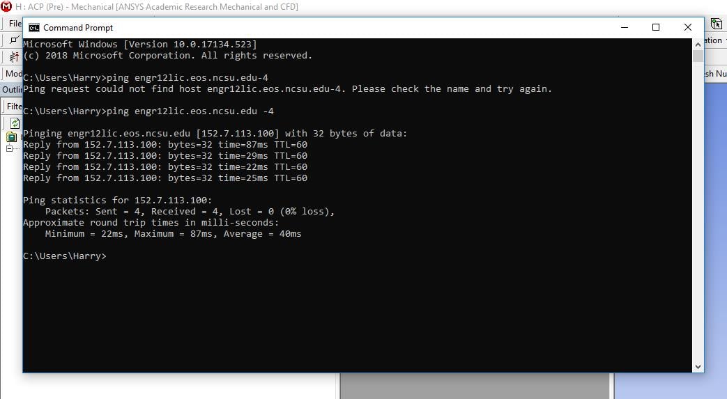

      Yea, this error is from the fact that you can't communicate with certain port on the license server. This however isn't related to the ports used for license checkout. So, we can leave it like this at this time. Can you post the output of this command in the CMD Prompt
      ping engr12lic.eos.ncsu.edu -4
    • harryygee
      Here you go Win,
      This is what I got
    • tsiriaks
      The ping is quite slow but not that slow to make you see the issue "licensing server to X amount of seconds to respond."

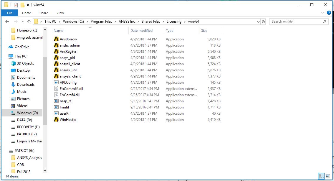

      Please post the screenshot of the content of this folder (assuming default install location) C:Program FilesANSYS IncShared FilesLicensingwinx64
      Thanks,
      Win
    • harryygee
      assuming this is what you wanted to see? also this happens from time to time, I notice the program running the most slow when I go to update or build a solid model from an ACP module.
    • tsiriaks
      Yes, that's what I wanted to see. This seems fine.
