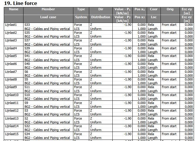

      Hey, I am looking for some help!
      I am using Ansys to determine the static loads of a staircase I designed. I have given my client the reports with the 3D images with the forces illustrated. However they have said they need a report which shows the results in the more traditional analysis of trusses method e.g. with tables such as what is attached and 3D/2D drawings just with the different nodes illustrated. From what I have seen, this is not possible to make on Anysys, just want to check I havent missed anything.... does anyone know if it is possible to generate such reports?

      Please see if the following link helps:
      https://ansyshelp.ansys.com/account/Secured?returnurl=/Views/Secured/corp/v241/en/wb_sim/ds_Reports_Customizing.html
