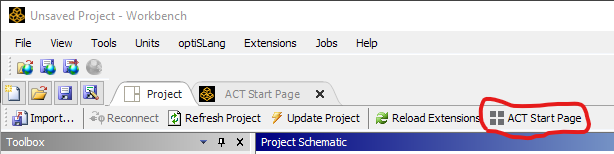

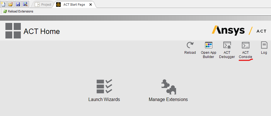

Forum ModeratorAnsys employees won't be able to help with third party softwares, but there are a couple of script editors in workbench:
Using either ACT console
or ACT debugger.
For starting a script at start of the workbench Please check the command line execution arguments:
