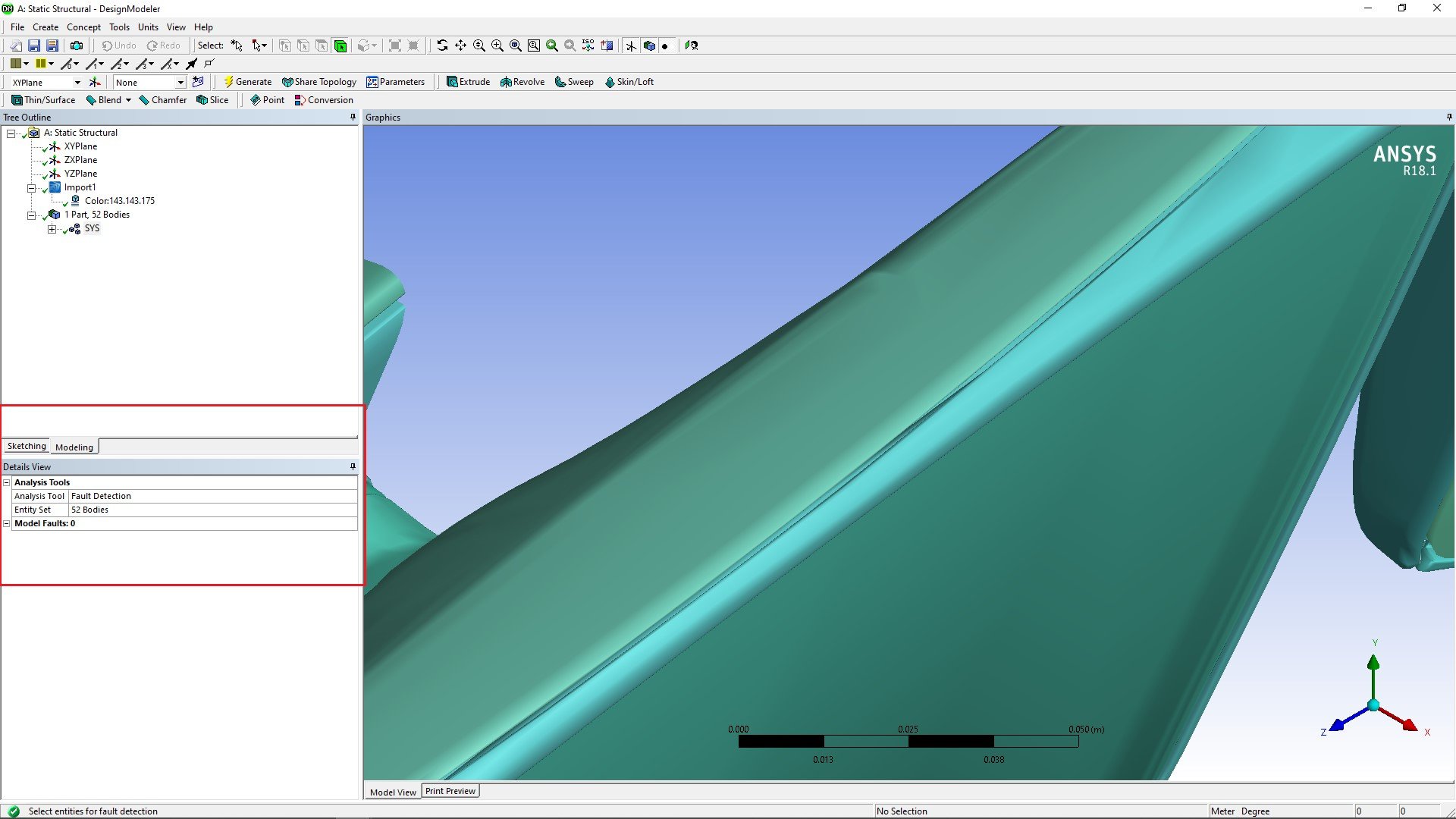

      Hi, ni also facing the same issue with my CAD model, i am attaching the error picture please have a look and suggested me the solutionnnn

    • Chandreshyadav
      Whenever i am doing meshing i am facing this error nGeometry ( i think there should be a green tick instead of question mark)nError message after running mesh/ generating mesh ( mesh is not happening).ni also checked with the Fault detection, there is 0 fault. nplease help me to resolve this issuennRegards nChandreshn
