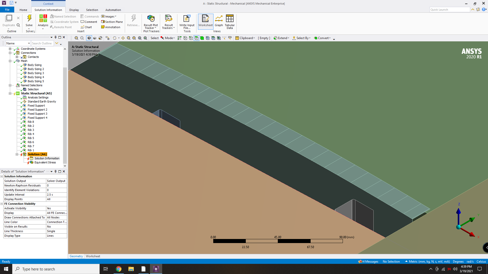

      I have a similar case, it's a static structural analysis and it keeps getting stuck at the same point: creating solver input file. I have 1 step and I'm working on a single PC, on a local drive. Another thread recommended working on local drives and you recommended lowering the steps to 1, which I did and that's why there are some suppressed loads in the picture:nnMaterials are set up correctly and bodies have their materials assigned. The mesh is up to date too, the fixed supports represent the pins that mount the represented wing to the fuselage and the connections are all bonded contacts. I don't know what else could be creating this issue.nEdit: I also performed the steps mentioned by the original thread creator. Also: in the Workbench the setup update will just fail, giving an error message along the lines of 'Update failed for the Setup component in Static Structural. The Setup component in Static Structural does not contain all entity types advertised in its component template, even after update'n

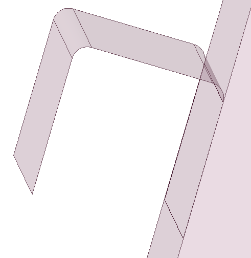

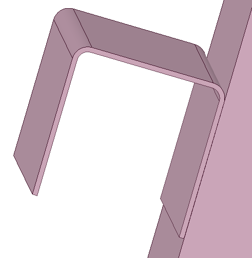

      Hey Daniel nThe reason why this model stalls is because you have tried to mesh thin-walled solid geometry with solid elements. That is a mistake. Unfortunately, some of your thin walled parts have been united into a single solid such as this one.n You need to convert these solids to surfaces. You can do that using the Midsurface button in SpaceClaim. Or you can just copy/paste one side of the solid and discard the solid.nTry again when you have only surface bodies that you can assign a thickness property to the shell elements that the mesher will cover the surfaces with.n
    • danielmartinezf
      Yes sir, it finally got past that stage after changing every body to a midsurface and removing duplicates/checking the model. Thanks for your helpn

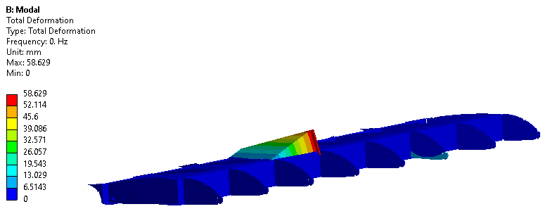

      Hey Daniel nThe problem is that you have not connected all the parts together. Drop a Modal analysis on the model and drag and drop the four Fixed Supports down. You will find parts floating around.nNote that there are 6 zero frequency modes. Keep adding contacts until you get a nonzero first mode.n
