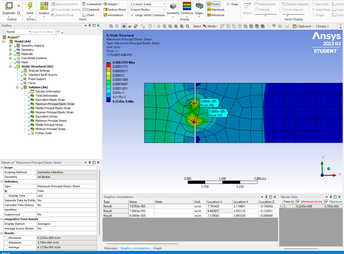

SubscriberGood day everyone, I was wonering if anyone would know how to place a probe in the same manner you would with the GUI using the Automation API for Ansys Mechanical (see image below). If so, would you also know how to pull that specific value out just like using the built-in method ExportToTextFile?

Hi
See this for some help perhaps:
https://discuss.ansys.com/discussion/comment/1436#Comment_1436
https://discuss.ansys.com/discussion/1145/how-to-export-graphics-annotations-result-to-a-text-file
If it does not help post a question in that forum instead.
