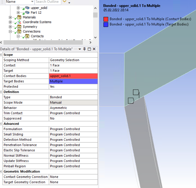

I am doing transient structural simulation in Fluid-structure interaction framework.
I set a bonded contact between two surfaces. According to the user's guide - "If contact regions are bonded, then no sliding or separation between faces or edges is allowed. Think of the region as glued".
However, as you can see in the deformation picture (true-scale image), there is some substantial sepatation between the bodies. What setting should I change to avoid this?
I also tried to set the same thing in connections --> joints, but the effect was the same.
I applied the contact just because these two bodies has got different material properties. Maybe there is some other way to assign different material properties to two regions, beside this contact?
kind regards

Subscriber,if you want to model the bodies as if they are glued (i.e. there is no relative translation or rotation between the faces of contact), then there is an easier way than applying a bonded contact.
Use Shared Topology option in the SpaceClaim or DesignModuler between the two bodies, which, as the name suggests, connects/shares the nodes on each face by applying a conformal mesh on these faces. This way, you don't need to apply the bonded contact or joint any more to connect these two faces.
Bonded contact can be used if you are trying to determine the force transfer between these two bodies, and stresses/pressure on the faces of the body in connection. If your target is to only transfer the force (without getting into too much detail how much force is transferred), then the prime option to opt for is Shared Topology between these faces.

SubscriberYeah, thank you for help. Now it works, I just created single part of these two bodies in Designmodeler, and I used shared topology.

Subscriber,well I don't have your model so I don't know why exactly the bonded contact did not work. Maybe you can add a Contact Tool and check if the contact is created properly or not. Sometimes, the contact is not created properly and it doesn't work during the analysis, so a trick is to actually notice that beforehand, by using the Contact Tool. This tool will tell you if the contact will be tracked during the solution or not.
