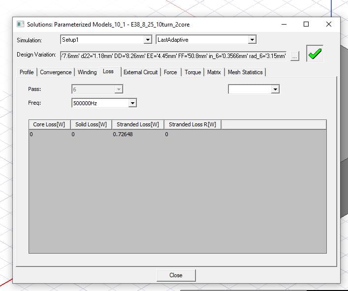

SubscriberI select stranded in my Maxwell 3D eddy current simulation to simulate litz wire. The loss tab displays a quantity called "stranded loss". For Litz Wire operating at any frequency the loss components for the wire are DC Copper Loss + AC Copper Loss
Is the stranded loss displayed in Maxwell 3D eddy current simulation the total loss or just the AC copper loss? I attached a pictureÂ
November 15, 2019 at 11:34 am
mbeliaev
Ansys EmployeeHi,
only DC loss. You can use new feature Litz Wire modelling, please see help section. Otherwise you need to simulate all objects separately to represent real geometry and set each object as solid.
With litz wire model you can see strandedlossac quantity. StrandedLossAC includes DC losses and additional AC losses due to skin effect and proximity effect.
