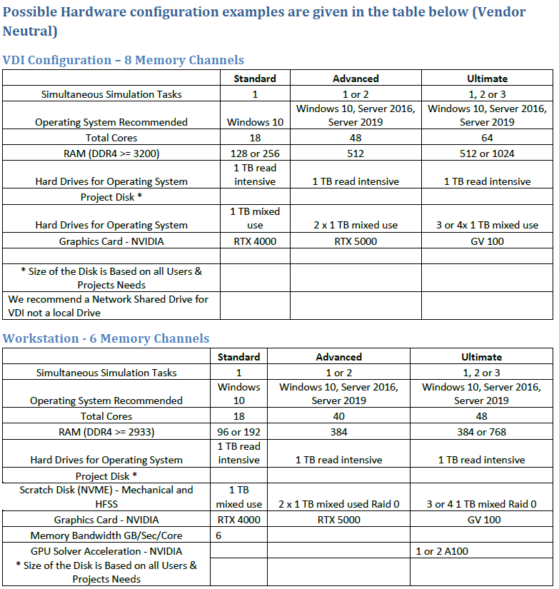

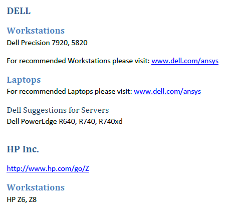

    • NKC
      Here are some standard PC recommendations from Ansys. How fast your simulation gets completed is highly dependent on how big is your model and how you mesh it.
      For efficiency, HFSS needs at least one host CPU core for each PCIe GPU. So, for 8 GPUs it needs 8 cores minimum.
      As a general guideline for most applications, scalability will saturate quickly for more than 32 cores in a single machine.
      How the GPUs are used depends on the HFSS solver. For example, for HFSS Transient the solver will first use all GPUs for solver tasks and the remaining tasks will use multi-core CPUs. The other solvers have a similar logic. In general, the solvers will try to maximize GPUs usage when GPU acceleration is enabled.
      The following guidelines are a viable choice:
      ÔÇó 2x 16-core Intel Processors at 2.8-3.1GHz.
      ÔÇó ANSYS does not recommend AMD processors due to the lack of optimized AMD math library support.
      ÔÇó AMD math library Support tentatively scheduled for HFSS 2022R2
      Electronics - GPU and CPU - General Guidelines:
      ÔÇó Several Ansys Electronics Desktop solvers can benefit from GPU acceleration:
      ÔÇó HFSS frequency domain, transient, and SBR+ solvers.
      ÔÇó HFSS 3D Layout for matrix solves and eye analysis.
      ÔÇó Maxwell 3D eddy current matrix solves.
      ÔÇó Circuit Design for eye analysis.
      ÔÇó Circuit Netlist for eye analysis.
      ÔÇó EMIT
      GPU selection is based on the type of solve
      ÔÇó SBR+ solvers can benefit from single-precision GPU's with higher memory bandwidth, such as NVIDIA RTX series.
      ÔÇó All other solvers require GPU's that are capable of double-precision floating-point calculations, such as NVIDIA A100 or V100 or P100 series.
      ÔÇó If installing multiple GPU's make sure all GPUs are from the same series and as adequate level CUDA installed and GPU's set to computational mode
      ÔÇó PCIe4
      ÔÇó CPU RAM at least 2x of the accumulated GPU RAM
      ÔÇó Enough power from PSU

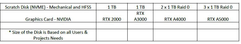

      Hard Drives (See additional information below based on the solver you will be running)
      ÔÇó SSD NVMe ÔÇô 2 x 2TB for 4 TB of off-core additional memory/storage
      ÔÇó Local disk is recommended for the solver for temporary file I/O during solves.
      NOTE: Ansys recommends at least one drive for boot and applications (SSD) and at least one drive for solving M2, NVMe drives
      Platform Support and Recommendations | Ansys
      Regards Navya
