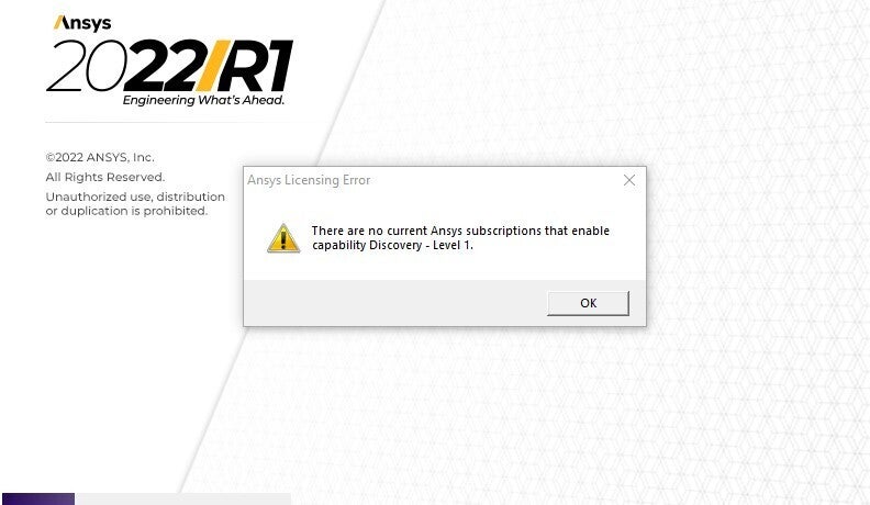

      When trying to run SpaceClaim 2022 R1 an error message comes up. (see attached) and it will only open in read only mode. I have double checked that there is an Ansys Discovery Modeling (named user) subscription assigned to me and the licensing mode manager is set to subscription.

      I see that your license is not activated on any device. Please can you try activating the license through command prompt and see if that helps. The instructions are mentioned in the article below:
      Discovery Subscription license - Command line options - Knowledge Base - Ansys Discovery Forum

      That did it! thank you!
