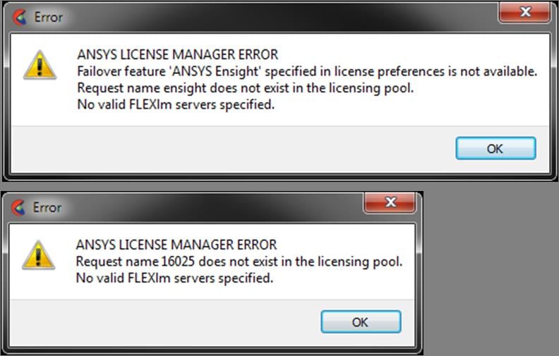

SubscriberEnSight is having a trouble with finding a license file even though the Ansys License Manager is up and running.
Briefly, we've been using CEI (Computational Engineering International) EnSight for CONVERGE Science CFD and everything was easy in terms of setting up a server and clients, and this is the first time for us to get a license from Ansys and nothing seems to be straightforward.
Here's the step that we followed based on their instruction:
1. Log on to the Customer Portal. 2. Go to Downloads / Current Releases / Choose v19.1 and my platform 3. Academic Packages > Fluids & Structures package 4. Downloaded FLUIDSTRUCTURES_191_WINX64.zip and PREPPOST_191_WINX64.zip   Note: I don't understand why they instructed us to download everything under Fluids and Structures Package, but I simply followed the instruction anyway. 5. Unzipped both of them, and from the unzipped PREPPOST_191_WINX64 folder, ran setup.exe and installed only the Ansys License Manager (ALM). 6. Launched the ALM, and installed the key that they provided. 7. Launched the newly installed EnSight, and we keep getting the license error as shown in the screen capture below.  FYI: All is done on a server.   Thanks for your help in advance. Â

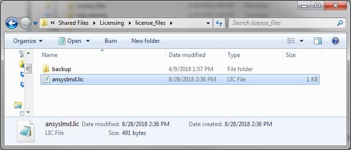

Unfortunately, I don't see "ansyslmd.ini" from the Licensing folder (see the screen capture below). I do see a license file (ansyslmd.lic) in the license_files folder though, and I don't know how to make EnSight look at that folder as it doesn't pop up any options to choose as it used to. Please advise. Thanks again! Joseph

Ansys EmployeeHi Joseph,
Did you use the FLUIDSTRUCTURES_191_WINX64.zip to install Ensight software or it was installed by other package ?Â
If the Ensight was installed by either the package above or 'Fluids' package, you should have it under v191 folder (e.g., C:Program FilesANSYS Incv191CEI ) and this would use (and automatically create) the ansyslmd.ini on the relative directory to that v191 and should have the content like what I described.
If the Ensight was installed by other package (e.g., Ensight products page or the legacy Ensight website) , it will install on the other location. In this case, you can try setting these environment variables
ANSYSLMD_LICENSE_FILE=1055@hostname
ENSIGHT10_LM=ansys
Note: Replace hostname with the actual hostname of the license server.

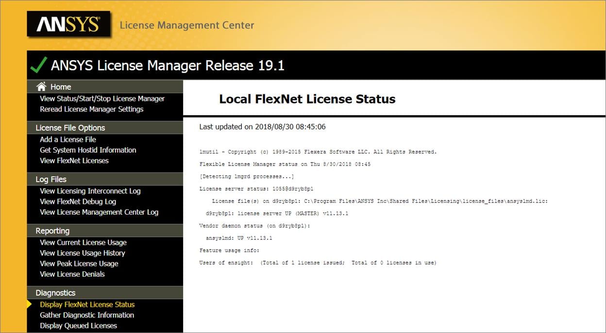

August 30, 2018 at 12:50 pm
cjhun
SubscriberHi Win,
Please see the attached screen capture. In case of you not being able to read well from the image, it says:
Last updated on 2018/08/30 08:45:06
lmutil - Copyright (c) 1989-2015 Flexera Software LLC. All Rights Reserved.
Flexible License Manager status on Thu 8/30/2018 08:45
[Detecting lmgrd processes...]
License server status: 1055@d9ryb8p1
License file(s) on d9ryb8p1: C:Program FilesANSYS IncShared FilesLicensinglicense_filesansyslmd.lic:
d9ryb8p1: license server UP (MASTER) v11.13.1
Vendor daemon status (on d9ryb8p1):
ansyslmd: UP v11.13.1
Feature usage info:
Users of ensight: (Total of 1 license issued; Total of 0 licenses in use)
