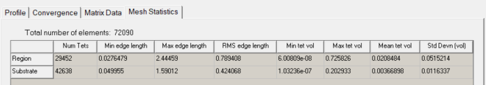

      In HFSS, you can check 'Mesh Statistics' which provides information on Total mesh element count, and some statistical data of generated mesh elements after adaptive passes completes. This data is num tets, min/max edge length, min/max tet volume etc with respect to geometries in the simulation. This information can be geberated from Project Manager, go to Results > Solution Data > click on Mesh Statistics tab
      However, I don't this there is an option to get co-ordinates of each mesh node after adapative passes.

        I've also found the following discussion (How to export the resulting fields of a ANSYS Maxwell3D simulation) that it is possible to achieve what I want to achieve with the "write" output command in the field calculator. I've outputted mag_E using following this. Could you also comment on out to interpret the outputted file (attached screenshot)?

      Regarding the output of the Write command using Field calculator, the output shows Emag at various mesh elements which are tetrahedras. The order of the basis function determins the number of unknowns calculated over each tetrahedra.
      The HFSS help PDF document has a technical note on ‘The Finite Element Method’. Please refer to understand more about it.
