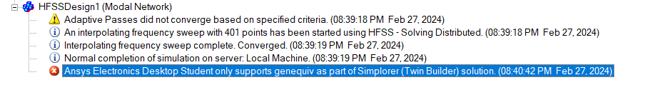

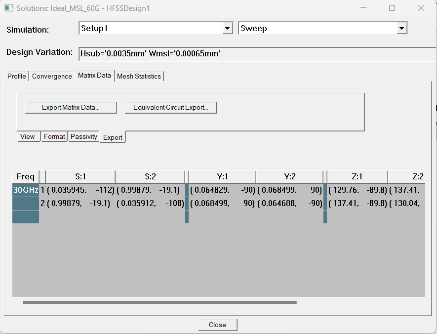

SubscriberIn ansys HFSS, I am trying to export the equivalent circuit of a microstrip line I have designed. But, when I click on "Equivalent circuit export..", the analyzer is showing the error "[error] Ansys Electronics Desktop Student only supports genequiv as part of Simplorer (Twin Builder) solution.". Could anyone please help me in this. I am trying to obtain the equivalent circuit of the microstrip line I have designed.

Please note that you can export equivalent circuit only in Twin Builder format for AEDT student version as mentioned in the error.
