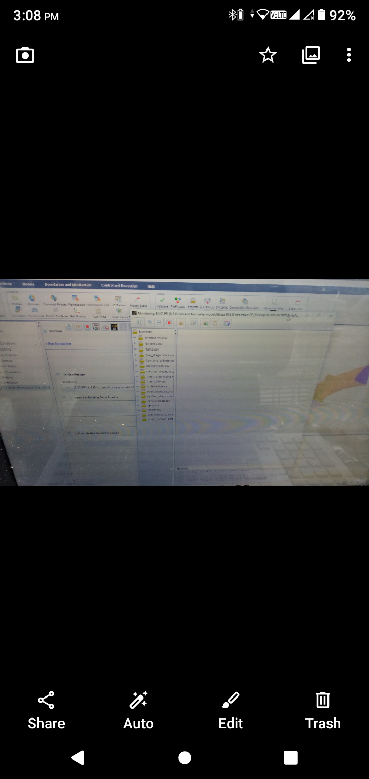

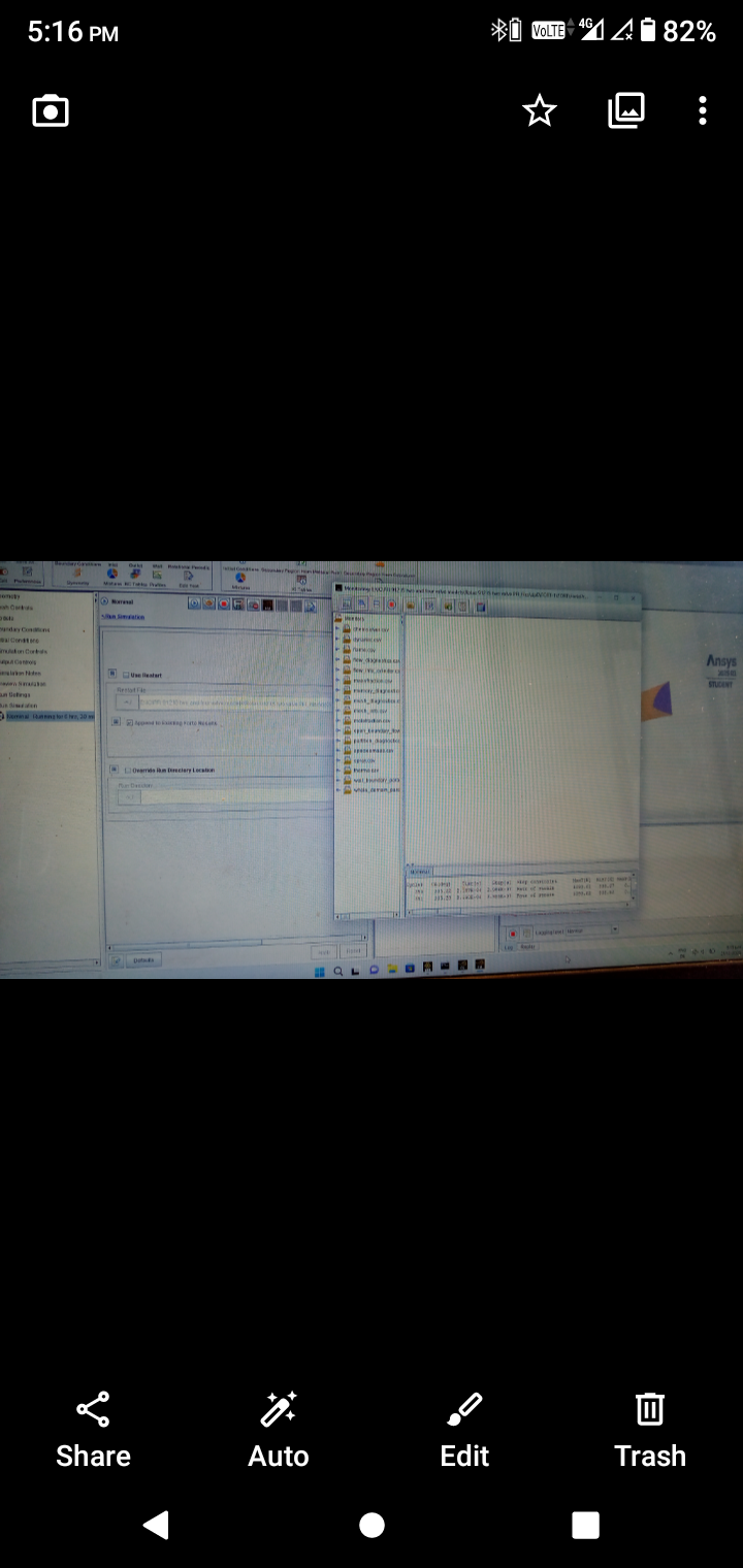

SubscriberWhat do the three rows mean in above image?
I did open FM , didn't progress after I put laptop to sleep even I have solution saved after every one crank angle. Selected update on solution tab but didn't pickup from previous saved crank angle, rather restarted altogether.

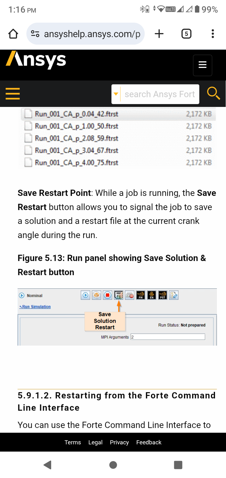

If you are looking for guidance on Forte restart. Please refer the following section 5.9.1 in Forte user guide (24R2 manual). Section number could change will different releases.
5.9.1. Restart Files and Processing
Each of these icon - mean different things. If you hover your mouse over them - it will give short details. FM is meant for monitoring runs, EN - opens ensight and PST-Opens CFDPost

Ansys EmployeeHi Hasan,
Your snippets are very blurred. I would recommend you to share clear pictures so that i can guide you.
Have you gone through the section on Forte restart from User guide manual (link shared in an earlier response) ?
July 23, 2025 at 5:51 am
Hasan
SubscriberYes I have and what I understand is if you press the Save Solution & Restart while it's running then it will save (which it does). Then a few hours later when you switch on the laptop back, press the same button again and it should restart continuing from last save. This doesn't happen, most likely I missed something. Thanks.

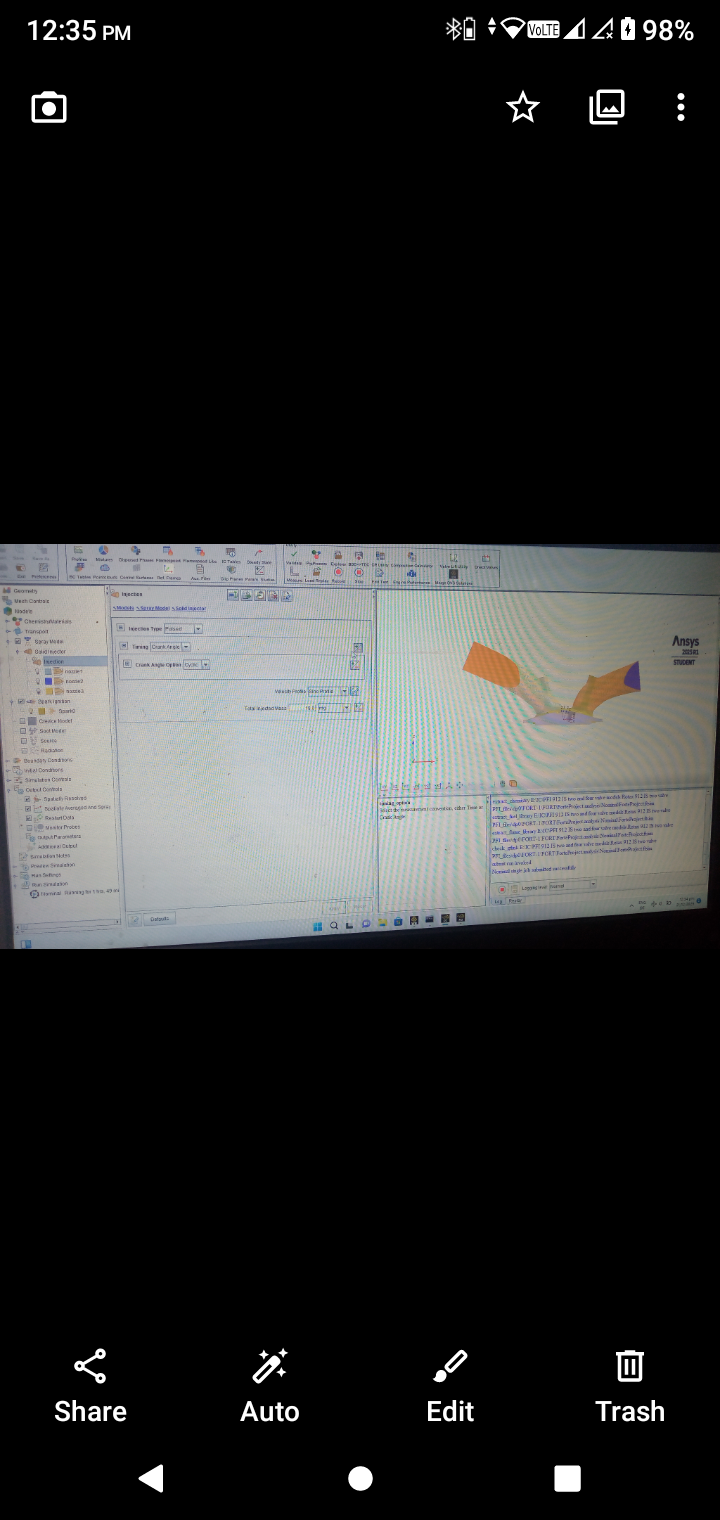

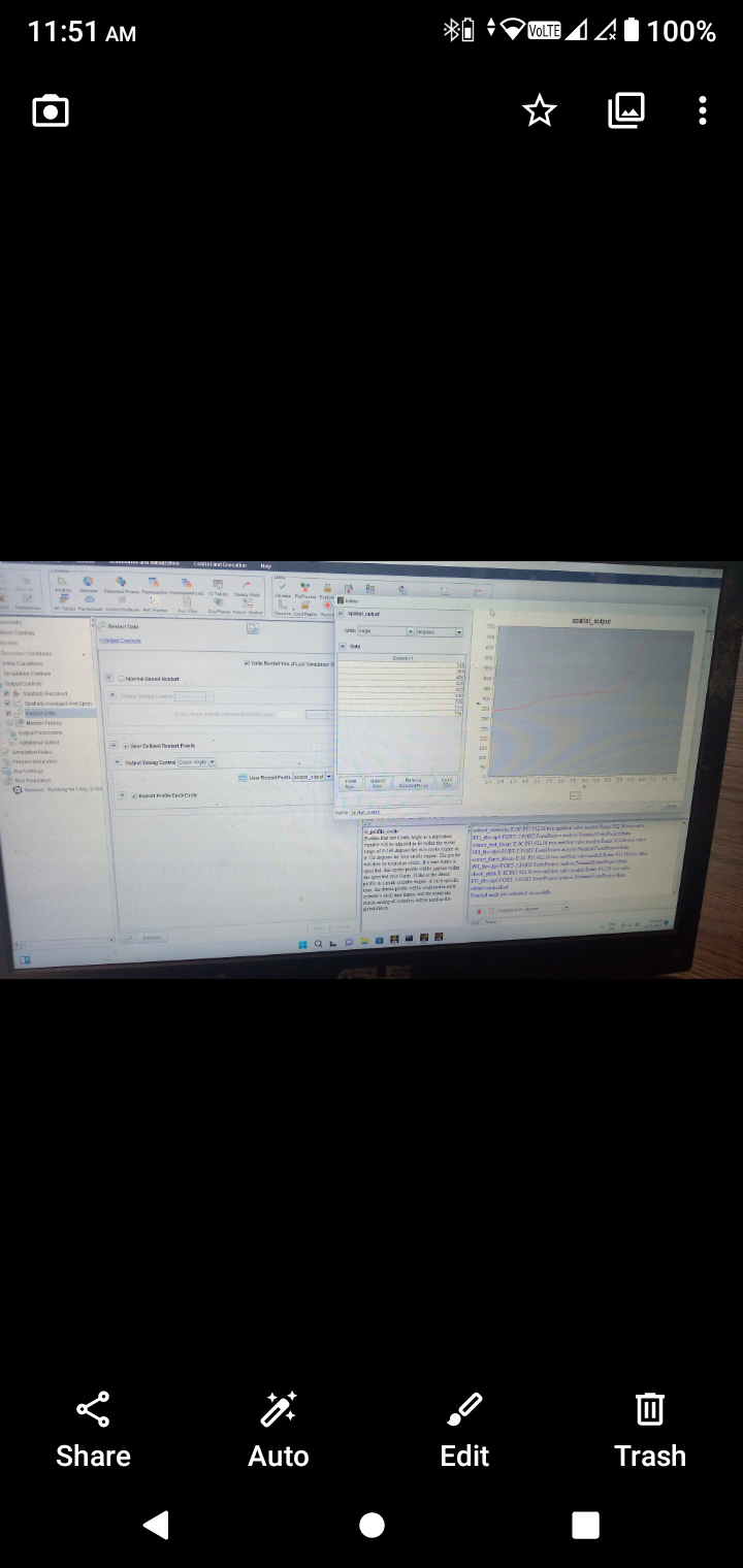

SubscriberNot sure how to setup parameterization in Forte , please see attached image, got three different crank angle spray timings and it's running now but not sure if this is the right way.
