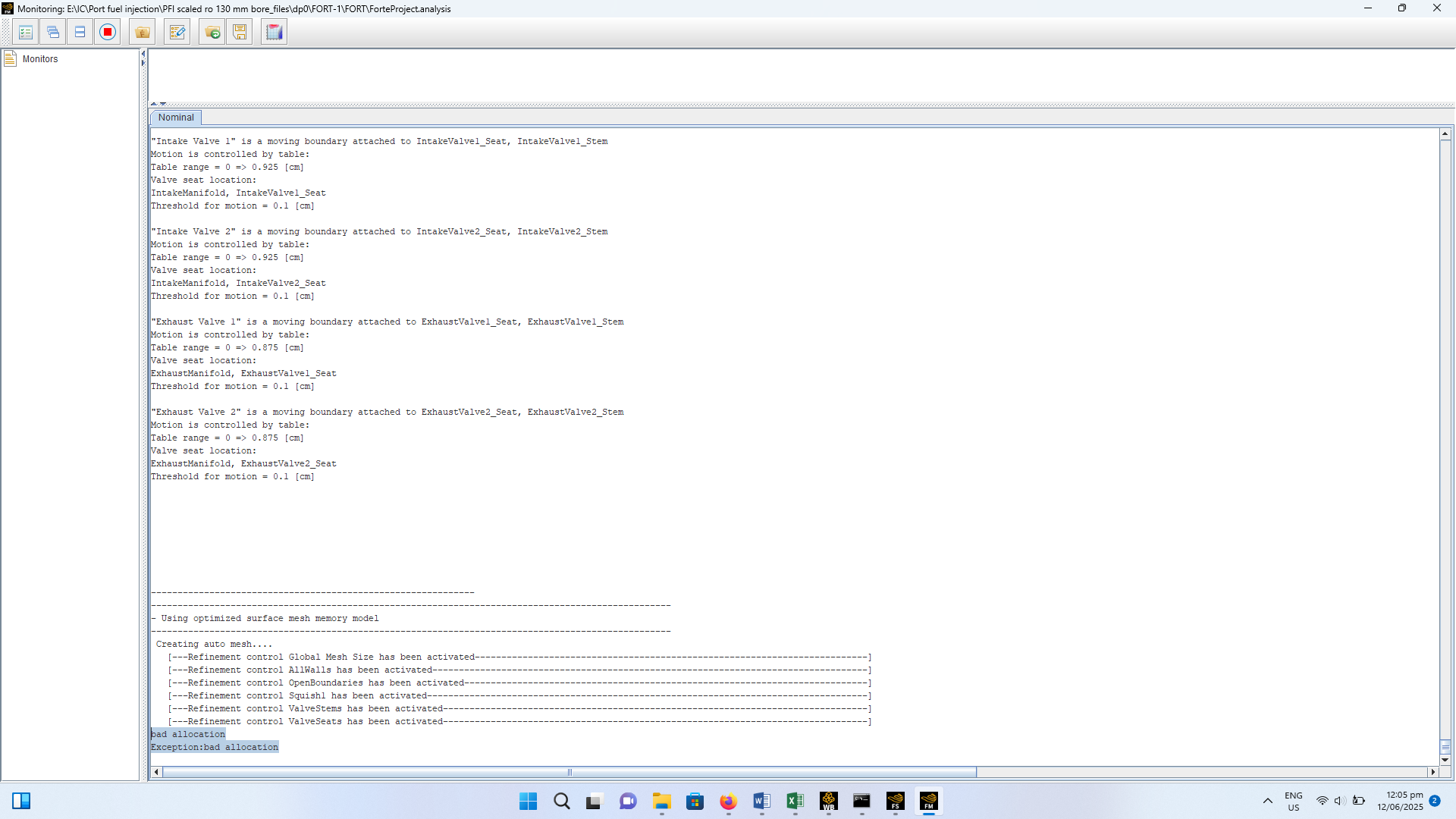

    • Hasan
      How do I resolve this? Tried so many solutions . I t says "bad allocations" , "exceptional alloacation" and then nothing happens.
