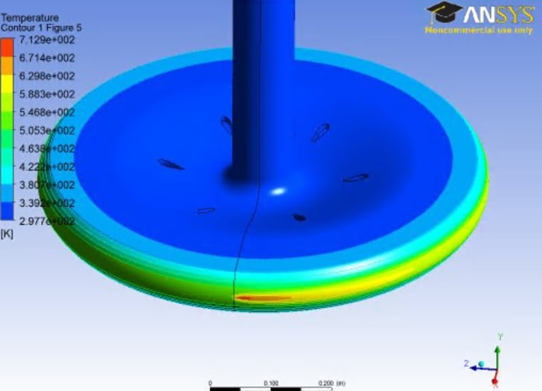

      I'm trying to use a udf to simulate a heat source all around the walls of a titanium drum (with water inside).
      I attached an image of the CFX simulation showing the heat applied on the walls.
      Now I want to do the same in fluent. So I'm using the udf define_source, in particular I want that the heat is applied only on the external walls (this means when the position is equal to the radius of the wall) and only in the middle of the wall (so when y=-0.04).

      A source is used to add stuff (energy in this case) to a volume (solid in this case).  If you're trying to add heat to an external wall you'll need a DEFINE_PROFILE.

      In this case though I want to add energy in a volume close to the wall (W/m3), let's say 1cmx1cmxdrumperimeter.
      In the simulation anyway the drum is turning at 63 rad/s, maybe the fact that is turning could be the cause of the wrong if statement?

      Rotation shouldn't matter, the source will apply to the cell zone.
