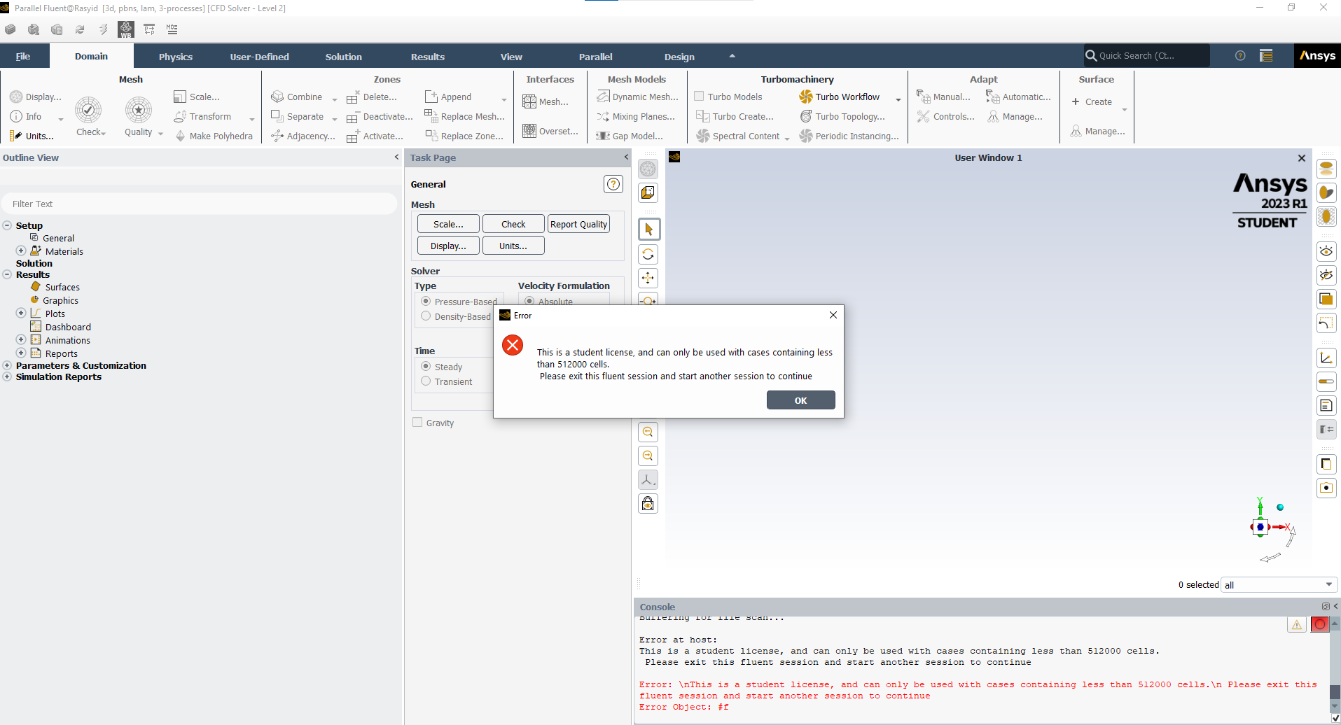

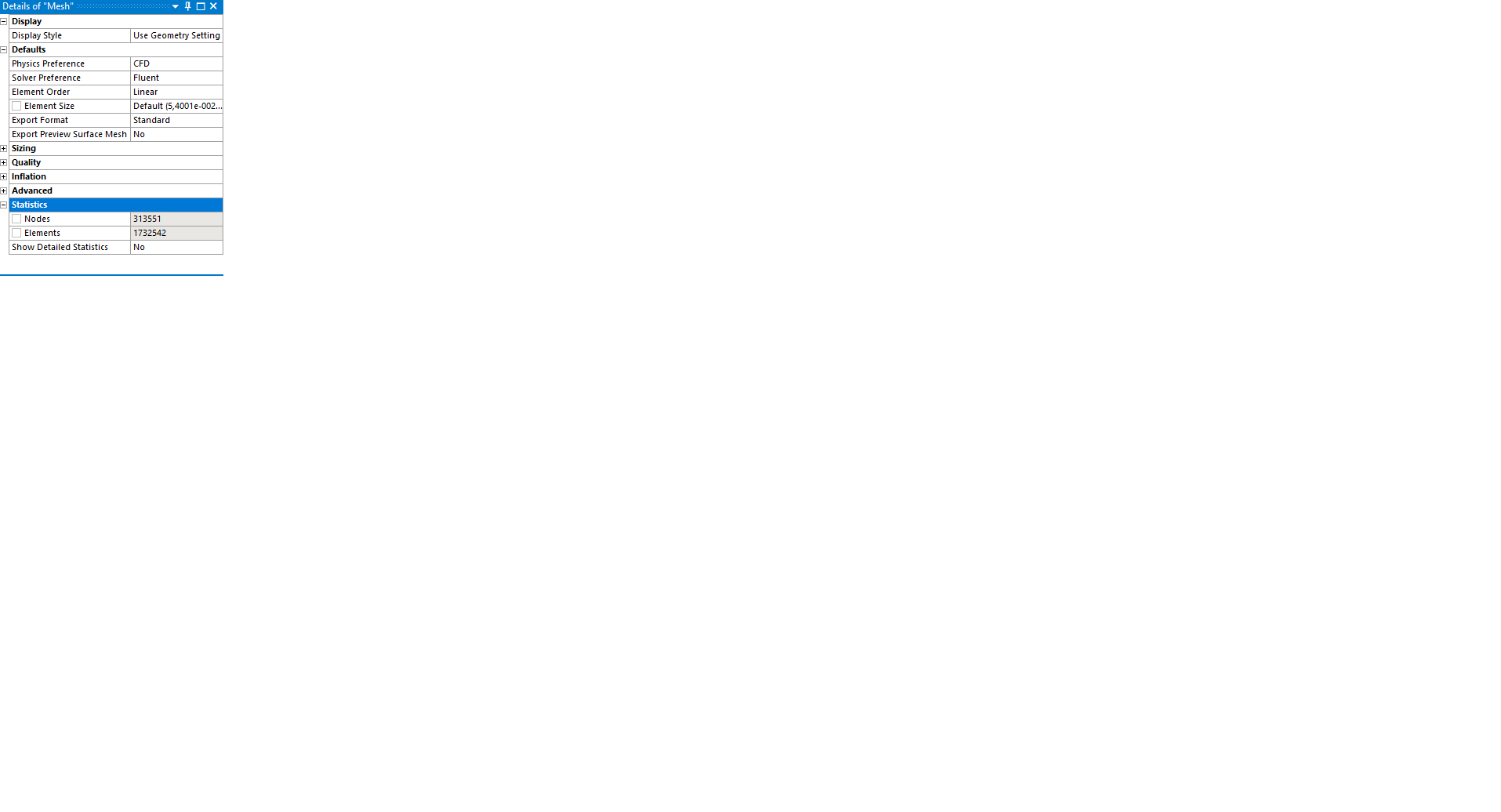

SubscriberAs i know that ansys cfd have 512k nodes limit for student version, but why when im trying to input my mesh (my model only have 313k nodes) to Ansys Fluent i got this error "this is a student license, and only be used with cases containing less than 512000 cells. Please exit this fluent sesion and start another session to continue". Anyone have the same issue? and how to fix this

Ansys EmployeeHello. This could be because your mesh cell count (not node count) is more than 512K. Please try with a mesh with a cell count below 512K.Â

Forum ModeratorCell count is 1.7M, which is a bit too big for the Student version.Â
