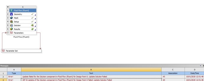

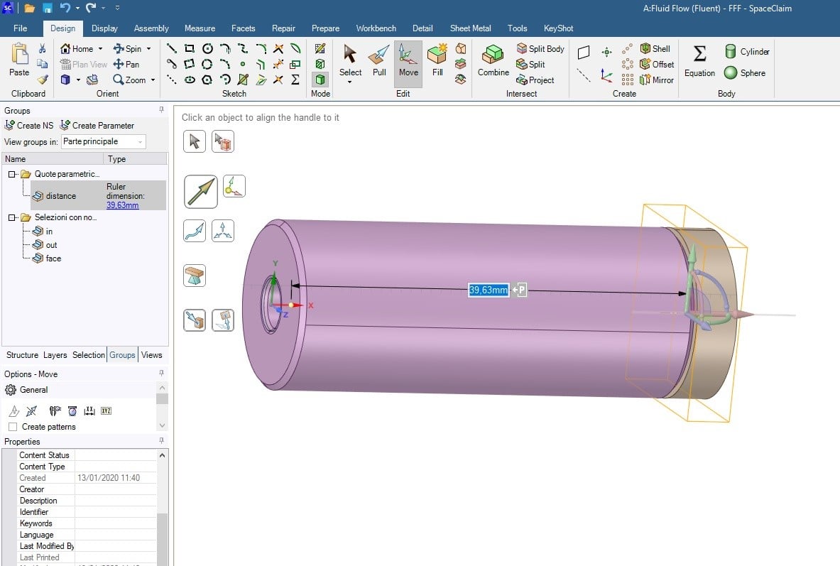

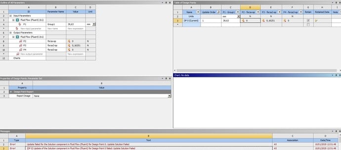

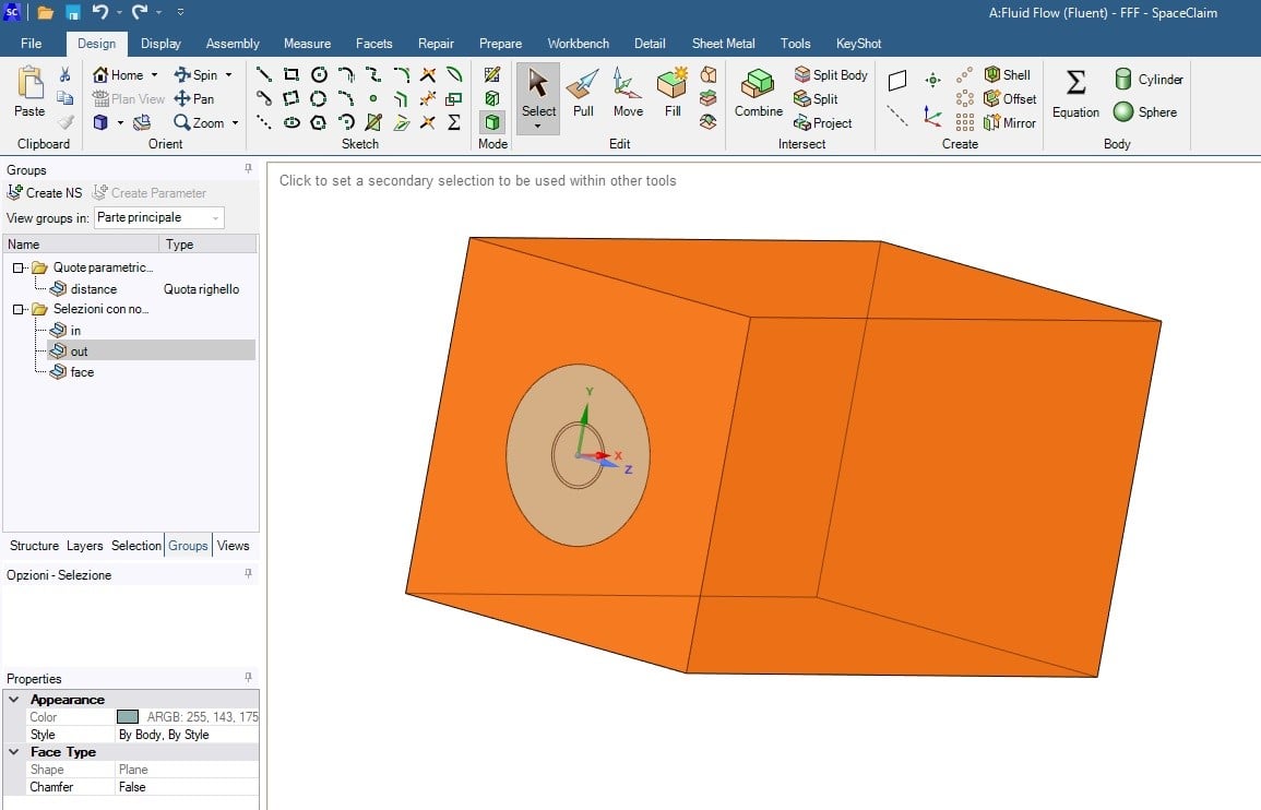

      I'm working with ANSYS 2019 R3 student license to calculate a force generated on a surface in a fluid flow (fluent) analysis. My system consists of 2 bodies assembled in space claim geometry. The first body is fixed to the referent system, the second body moves in one direction (this direction is my input parameter). My aim is calculate the force generated on the second body in relation of my input parameter. The problem is that when I update design points in parameter set window the program stops during "loading mesh and model information". Can someone help me?

      I manually tried to change my distance in geometry and parameter window (I used 39,63mm). Geometry and mesh are updated correcly, but the program gave me error in solution.

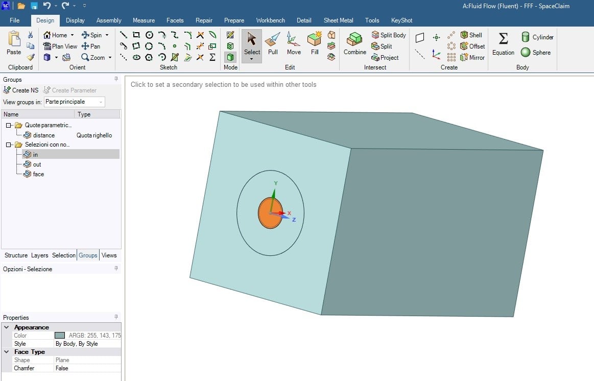

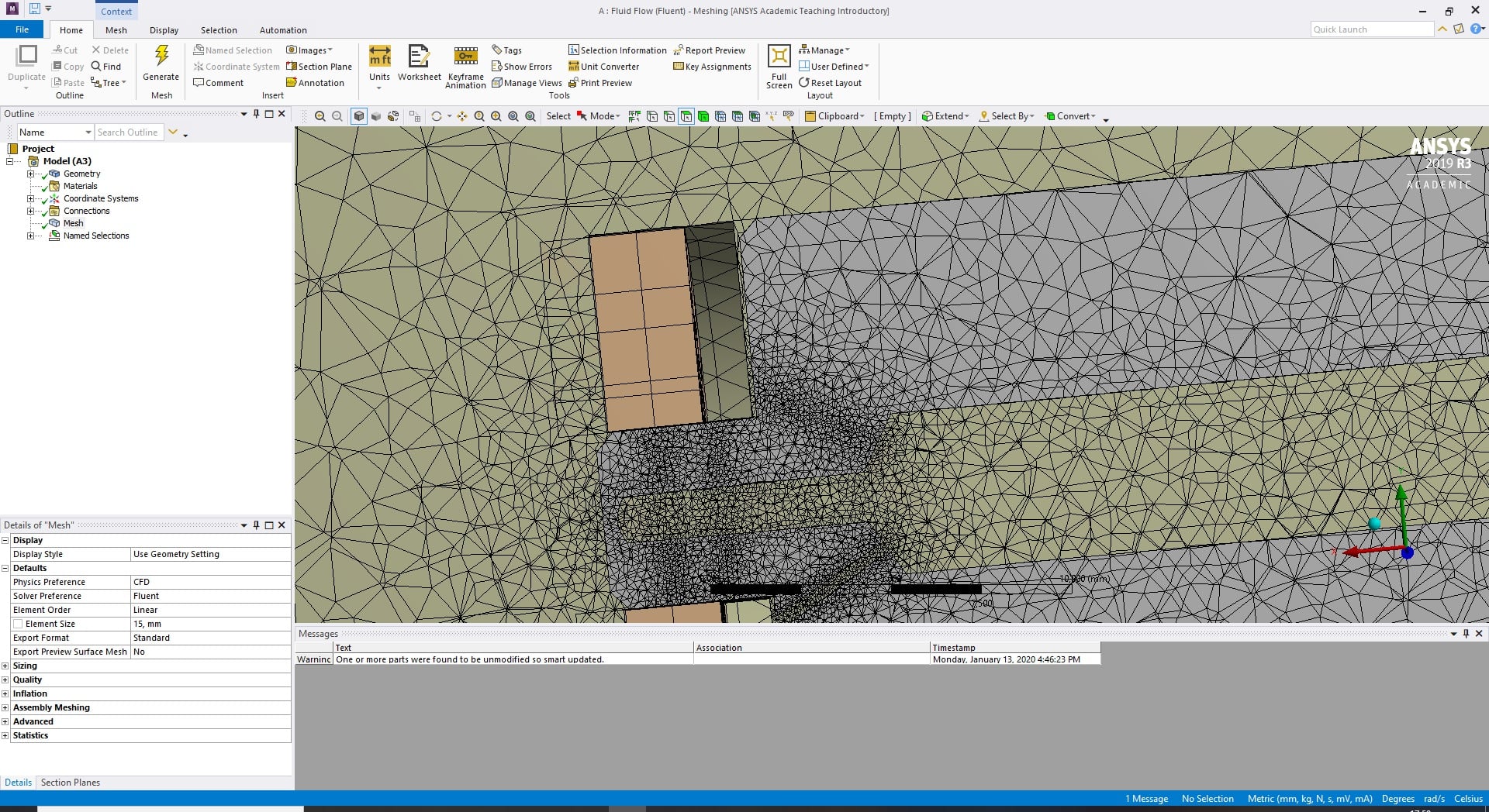

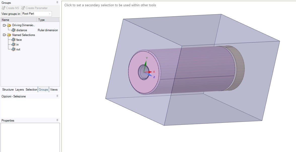

      I changed manually my input parameter and I have problems in mesh cell, in particular after the geometry update the program lost the definition of named selections "in" and "out" that are my pressure values in setup settings ("face" is the surface of the ring where I want to calculate the force value). The ring and the other body are imported by cad files, the volume where i define "in" and "out" is an enclosure created in spaceclaim.

      I tried naming my selection in SpaceClaim but if i change manually my input parameter and open the spaceclaim cell, the selection "in" and "out" disappear ("in" and "out" are the boundary of my reference volume obtained through the function "enclosure" in spaceclaim)

      Eventually  you need a much larger enclosure to have it comprising larger dimension. Perhaps better to use other method to extract fluid volume.
      Where are the inlet & outlet surfaces? Is the second solid moving, or are you just wanting to change it's position & re-run the model? What do the chamfers (x=0 plane) do?
    • msalvo4
      The inlet surface is the hole of the first body (I set pressure-inlet in setup), the outlet surface il the extremes of my enclosure (I set outlet-vent in setup). My aim is calculate the variation of force on the surface of the second body (ring) related to the displacement. I define this displacement like a parameter. My idea is to insert different parameter values in "parameter set" table and read automatically the different force results. The chamfers in x=0 plane are only a geometric feature of the first body, they are not rilevant to the global problem.
      In the last image the surface of the first body in plane x=0 is exluded from out selection.
    • msalvo4
      I tried to create a larger enclosure volume but I have the same problem.
      I also tried to create the enclouse adding in assembly mode a cubic body (I made a Boolean subtraction between enclosure and other 2 bodies) and declaring it as "fluid" in Cell Zone Condition (setup options). In this case the program keeps the "in" and "out" settings during the displaicement but the Boolean subtraction not change, so I have a empty region after the updating of mesh.
      I tried to consider the enclosure body without doing Boolean subtraction but in the solution the program considers a full fluid body and ignores the solid body, so i have no solution.
