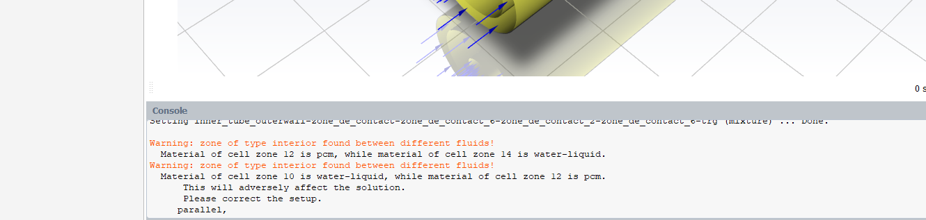

Forum ModeratorYou've got different fluids in adjacent cell zones but no wall between them, and no multiphase model switched on.Â

omar.ennaya
SubscriberYes that's it.
So i should activate the multiphase model.
Thank you sir.

omar.ennaya
SubscriberHello sir
I didn't activate multiphase model, should i? shouldn't just convert the interior zones discused in the warning into walls?
