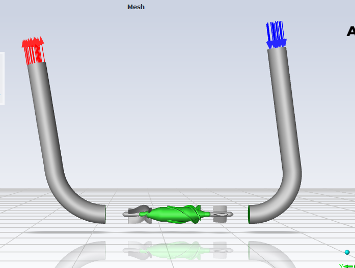

      This is a image of the pump being the green part the only one that moves. There is an external part to it but I am not showing in the image to be able to show the rotor.
      I tried other solutions but these is a summary of what I tried. I don't really know more what I should look at.

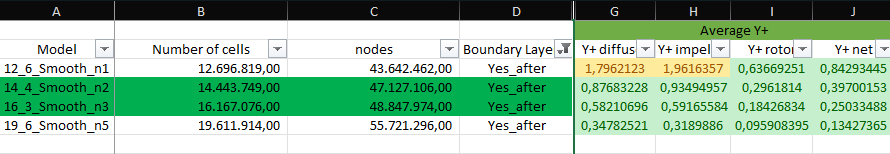

      Mesh / y-plus and prism layers:
      I am using Poly-Hexcore meshes. The simulations are currently being run with the ~14.4 million cells mesh. The average y-plus is very close to 1 (depending on the mesh level it ranges roughly from about 0.3 up to about 1.8), and on the impeller surfaces it is also around this range. However, I currently only have 3 prism layers in the boundary layer. I understand this is not ideal for the SST model and could affect near-wall resolution and separation prediction. I can increase the number of prism layers (e.g., 10 or more) and adjust the growth rate and total thickness accordingly. But independently of the mesh always the pump works as a turbine.
