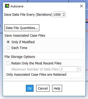

    • mossaied2
      Also this is my autosave window setup, I am saving the results each 1000 iterations, plz if there is something incorrect in it guide me
      Thanks
    • Keyur Kanade
      if you are auto saving after 1000 iterations, please make sure that you run more than 1000 iterations.
      please check if you have sufficient space on disk to write data files. also check %temp% area has sufficient space.
