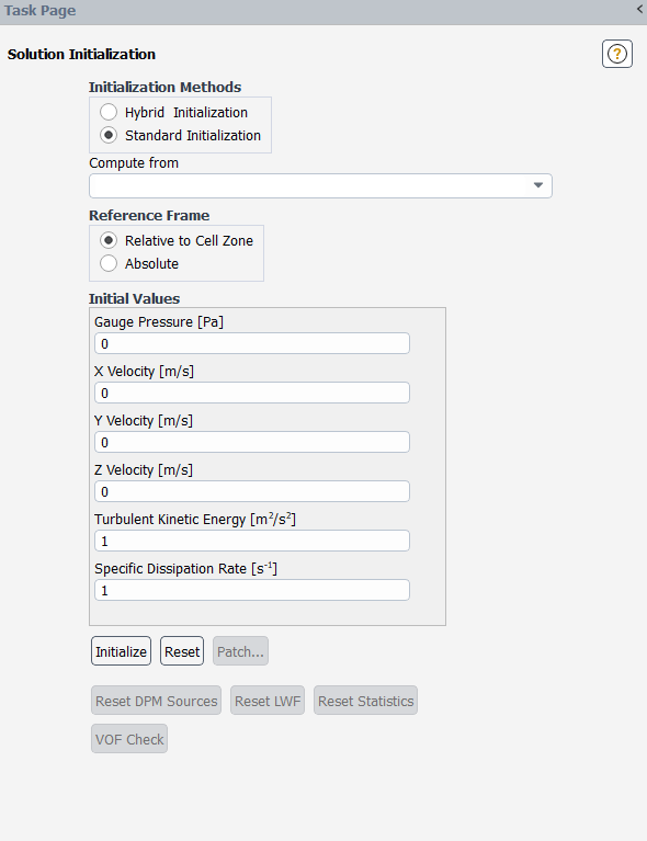

SubscriberOf course. So as you know we have two options in ANSYS Fluent when we are initializing a transient simulation: Standard and Hybrid (Please, take a look at the screenshot). I want to specify in the journal file that I am using the standard initialization. There is a command for hybrid initialization in the provided command list, but I could not find any commands for the standard initialization. Could you help me with that?

Ansys Employeesolve/initialize/initialize-flow will standard initialize your solution based on "default values".
To set the default values, use
solve/initialize/set-defaults/[quantity]/[value]Â to set the values for each quantity
To compute these values from an existing zone, use
solve/initialize/compute-defaults/[zone]
I suggest you try these in the TUI console for your case to see exactly how they should be written out
